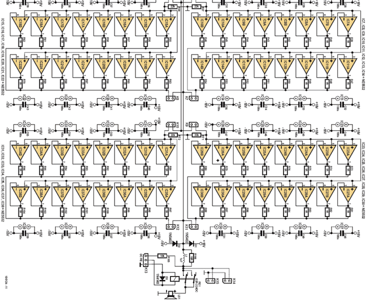

The audio expert Douglas Self says , it's good to connect many such cheap opamps as followers in parallel, with an output resistor from each opamp to the speaker. He himself tried paralleling 30 or 40 opamps to begin with. I think his speaker was 8 Ohm or maybe 16 Ohm.
https://www.elektormagazine.com/magazine/elektor-201010/19460
Link? Seems like strange advice to me for a couple of reasons...

This is how to connect opamps (their total price is less than 20 Great British Pounds, see the PDF)
  • Douglas_Self_Elektor_Amp5532_compressed.pdf
