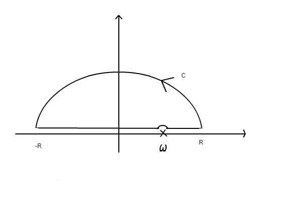

The reason I think it is wrong is because in the next part of the question it says:
ii) Show that for the contour C illustrated below, the integral of [itex]\alpha(\omega)[/itex]/[itex]\omega[/itex] vanishes along the semicircular part of the contour as R goes to infinite.
I've attached what the contour looks like but in case it didn't work, it's a semicircle in the upper half of the plane and it shows a pole (marked as [itex]\omega[/itex]) along the real positive axis. And the poles I found, if i did them correctly, should be on the imaginary axis.
Are the poles relevant to that next part of the question?
I would have thought the asymptotic shrinking of the integral would be driven by the growth of R, rather than anything to do with the poles. Indeed, if the contour ran into a pole, that would blow up the integral, rather than shrink it.
What is a parametrisation of the points on the contour?
I would think at this stage you'd have had the Laplace transform.
So for part (a), substitute s = jω (sorry, we EE's use j instead of i), then manipulate α(s) to look like (something)/(s + a). Then your pole is at s = -a.
As for part (b) the contour usually has σ for the x-axis and jω for the y-axis where s = σ + jω. I'm not quite sure what your plot is supposed to represent.
