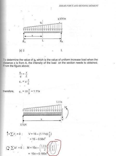

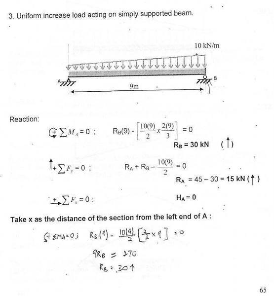

The cg of the distributed load is located 2x/3 from the 15N load. But since you are summing moments about the right end, the distance from the cg to the right end is how much?foo9008 said:Homework Statement
why the center of moment due to distributed load 1.11x is located x /3 from the 15kN , shouldn't it be located 2x / 3 from the 15kN end ?
is the author wrong ? [/B]
