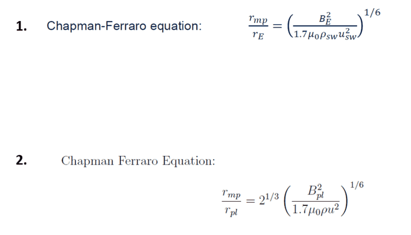

Hello,
Lets say you need to calculate the location of the magnetopause subsolar point on earth and you only have this information:
> Solar wind proton number density: 10 cm−3
> Solar wind speed: 700 km s−1
Chapman_ferraro equations:
What is the difference between the above chapman-ferraro equations? Why does one of them have 2^1/3 in front and one doesnt? What does the "pl" & "E" stand for?
Which one is more applicable to my case scanario?

It might help to know what source those two equations came from.

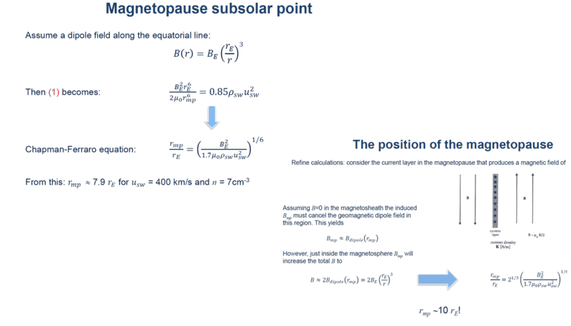

My suspicion is that the simple CF equation gives the midday (subsolar) radius, and that the added term of; 2^(1/3) = 1.26; gives the dawn or dusk radius.
So if you want realistic values, is it the second equation to be used? Because both give different results
They are different because they are applied at different times of the day.
The magnetopause is not a spherical surface with one radius.
Here are both equations mentioned in the slides.
Alright, could you help me understand what the signs in the denominator stands for.
What is the B in the numerator?
I assume the last term in the denominator is the solar wind velocity, the middle term pressure? And the u0 term is what?
https://en.wikipedia.org/wiki/Magnetopause
According to this link the p= density of the solar wind, v = velocity, B=magnetic field strength of the planet.
How do I get the μ0? Can I get it through the proton number density?
##B_{E}## and ##\mu_{0}## characterize the magnetic properties of the planet. The magnetic field of the Earth can be modeled as a magnetic dipole (https://en.wikipedia.org/wiki/Dipole_model_of_the_Earth's_magnetic_field), with the value of the field at the Earth's surface along the equator taking the value ##B_{E}=3.12\times10^{-5}\text{ tesla}##. And the magnetic permeability of vacuum, ##\mu_{0}=1.26\times10^{-6}{\rm \ N/A^{2}}##, is a basic constant of electromagnetism.

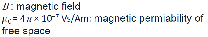

Are you sure about u0? Because it seems it should be 4pi * 10^-7 as it is the magnetic permiability of free space:
http://www.sp.ph.imperial.ac.uk/~mkd/AdvancedOption3solutions.pdf

Kovac said:
But I still dont understand why the second equation has 2^1/3 in front? Which one is more correct if you want to calculate for earth?
In post #7, the lower RHS of your attachment reads, as best as I can OCR;
"Assuming B=0 In the magnetosheath the induced Bmp, must cancel the geomagnetic dipole field in this region. This yields
Bmp = Bdipole(Rmp)
However, just inside the magnetosphere, B will increase the total B to
B = 2⋅Bdipole⋅(Rmp) = 2^(1/3) * ....
Do you want the Rmp, or do you want B ?
