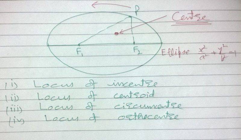

Dear Friends!
If we have a variable triangle formed by joining a point of ellipse and its two focii shown in figure,how to find locii of various centres.Can you please suggest some reference to find these .I have tried by using simple method for incentre locus which I left as it goes long. Though I am still thinking.

First off, locus is singular and loci (one 'i') is plural, not "locii."
For your ellipse, the two foci are at ##(\pm c, 0)##, where ##c = \sqrt{a^2 - b^2}##). Possibly you could write an equation for the locus of the various centers as the point P on the ellipse moves around.
The center of such a triangle is the point whose coordinates are the means of the corresponding coordinates of the vertices.
Here, you have a ellipse given by [itex]\frac{x^2}{a^2}+ \frac{y^2}{b^2}= 1[/itex]. Assuming that a> b, the two foci have coordinates [itex](-\sqrt{a^2- b^2}, 0)[/itex] and [itex](\sqrt{a^2- b^2}, 0)[/itex]. You can write a point on that ellipse as [itex]P= (a cos(t), b sin(t)[/itex] for parameter t between 0 and [itex]2\pi[/itex]. "Average" those coordinates.
(That turns out to be remarkably simple and gives a very easy answer!)

Dear friends ! In the solution of finding locus of incentre ,I am getting parabola as locus which does not seem to be by physical picturization.
Well, what did you do when you followed our suggestions? What is the "average" of the three points [itex](-\sqrt{a^2- b^2}, 0)[/itex], [itex](\sqrt{a^2- b^2}, 0)[/itex], and [itex](a cos(t), b sin(t))[/itex]? It is NOT a parabola! Please show exactly what you did.

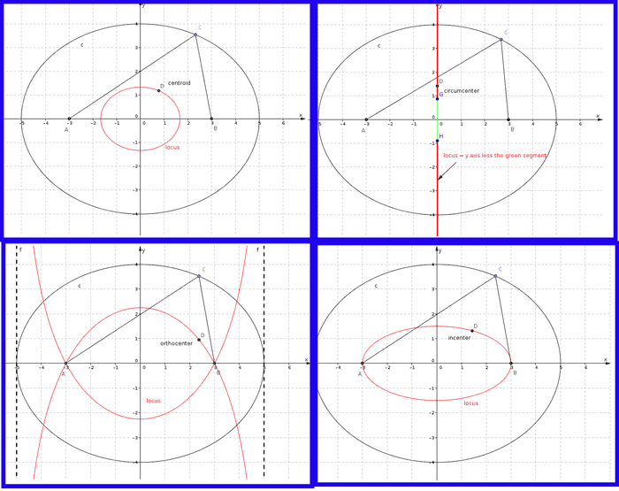

Incenter is the intersection point of bisector lines of the angles of the triangle
Circumcenter is the intersection point of the sides perpendicular bisectors
Ortocenter is the intersection point of the height
Centroid is the intersection point of the medians
The average of the coordinates gives the centroid.
The other points are less trivial to find
Incenter can be found using the formula here http://www.mathopenref.com/coordincenter.html
Circumcenter P has coordinates

Orthocenter O has coordinates

It can be quite hard to work it out...
Graphically it can be seen as in the following picture
I am referring to my first picture where I have evaluated locus of incentre.
Picture in #5
Thanks Raffaelel! I have calculated incentre locus in attached image in #5.Need to get it verified.
