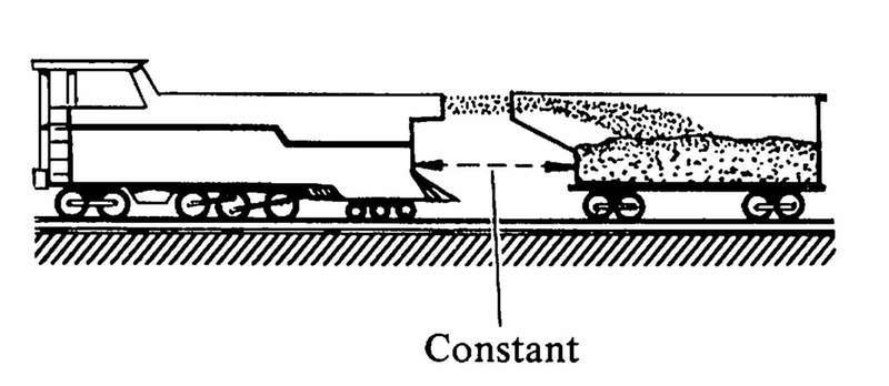

A sand-spraying locomotive sprays sand horizontally into a freight car situated ahead of it. The locomotive and freight car are not attached. The engineer in the locomotive maintains his speed so that the distance to the freight car is constant. The sand is transferred at a rate dm/dt = 10 kg/s with a velocity of 5 m/s relative to the locomotive. The car starts from rest with an initial mass of 2000 kg. Find its speed after 100 s.
I am actually not sure how to start because of the given constraint that distance between the locomotive and car stays constant.
Do I have to begin with evaluating P(t) and P(t+dt)? If so, what should be my system? Car and the incoming sand?
Any help is appreciated. Thanks!
This basically means the mass rate and the velocity of the incoming sand are constant with regard to the car, and you can forget about the locomotive.

I initially thought that I have to find the distance between the locomotive and car as a function of time, differentiate it and set the derivative to zero as the distance stays constant. Is this a wrong approach?
I still don't understand how to make the equations. Let the mass of car (without sand) be M. At time t, let the mass be M(t) and velocity of car be v(t).
##P(t)=M(t)v(t)+\text{momentum of incoming sand}##
But what do I write in place of "momentum of incoming sand"? :confused:
Consider what happens during some brief time ## \Delta t ##.

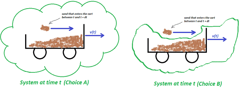

Pranav-Arora said:
Why P is Mv at time t? I mean, there is an influx of sand at time t also and you have not taken that into consideration. :confused:
It is very important to define your system. You can take the system at time t to include the cart plus the sand that is about to enter during time dt. Or you can choose the system at time t to include only the cart and consider the sand that is about to enter as an external agent that will act on the system during the time dt. Either way is fine, but you just have to be clear on what choice you want to make.
I am really sorry, I should have read my text carefully before asking the questions here. A similar example in the book shows how to select a system. :redface:
I will go with choice A.
At time t, the momentum of system is ##M(t)v(t)+\Delta m u## where M(t) is the mass of car at time t.
At time t+Δt, the momentum of system is ##(M(t)+\Delta m)(v(t)+\Delta v)##.
Conserving momentum, ##M(t)v(t)+\Delta m u=M(t)v(t)+M(t)\Delta v+\Delta mv(t)+\Delta m\Delta v##
Rearranging (I am writing v instead of v(t)),
$$\Rightarrow \Delta m(u-v)=M(t)\Delta v$$
Dividing both the sides by ##\Delta t## and with the limit ##\Delta t \rightarrow 0##, the equation becomes,
$$(u-v)\frac{dm}{dt}=M(t)\frac{dv}{dt}$$
Substituting M(t)=M+(dm/dt)t and solving the D.E, I end up with a strange answer.
$$v=-\frac{(dm/dt)tu}{M}$$
:confused:

Thanks ehild for the wonderful explanation! I have used your hints in my working above, can you please see if I did it correctly?
In what frame is the velocity of the car ##v##, and in what frame is the velocity of the sand ##u##?
In the frame of locomotive.
In the locomotive's frame, ## v = 0 ##.
u is the velocity of the sand with respect to the locomotive. The car and the locomotive travel with the same velocity, so u is also the relative velocity of sand with respect to the car. You see the car from the ground, where the velocity of the car is v and the velocity of the sand is v+u.
Use the appropriate velocity for the sand in the equation
At time t, the momentum of system is M(t)v(t)+Δmu
ehild
Oh yes, sorry about that.
Switching to the ground frame and as ehild suggest, the speed of sand is (v+u). Modifying the equation and solving the D.E, I get:
$$v=u\ln\left(\frac{M+(dm/dt) t}{M}\right)$$
