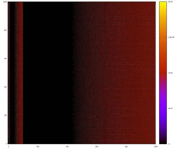

Rather than go that far, right now, I wrote a program to test all logarithms up to eight significant figures by simply counting through all possibilities, and generating three original numbers (domain values) for each possibility, eg: exact, +0.4999999e-8 or -0.4999999e-8
The program takes the logarithm of the original number, rounds *off* the result to the rule's significant figures, and then takes the antilogarithm and compares against the original value to compute an absolute value "error" for the rule.
I've only tested the natural logarithm to 4 sigfigs so far -- but you are basically correct; with Natural logarithms the rule yielded no errors whatsoever although with log base 10, small roundoff errors do in fact pop up all over the place.
The first roundoff error vs significant digts, when using log base 10, were at:
7.e-8 exact (1 sigfig)
5.3e-7 exact (2 sigfigs)
4.64e-6 exact (3 sigfigs)
4.402e-5 exact (4 sigfigs)
4.3635e-4 exact (5 sigfigs)
4.34830e-3 exact (6 sigfigs)
4.345571e-2 exact (7 sigfigs)
(still waiting to find the 8th sigfig error...)
In all cases, the error occurred in the same place whether or not 0.4999999e-8 was added, subtracted, or not done at all; and the error was a maximum of 1 least signficant digit. See attached plot of an earlier version of the program meant to test of up to 6 significant figures (e-6) with x-axis the 3 most significant digits, and y-axis the remaining significant digits of the original number -- and I made pixel color related to the absolute error of the result. Notably, the maximum error is red colored, which is 1 significant digit.
A brief look at the plot led me to reconsider your conservative rule of adding a digit at '5' or above. I think it would need to be '4' or above, or else perhaps (for more accurate easy memorization) say that for any number taken log base 10 which originally had it's most significant figures less or equal to those found in "the answer to life the universe and everything "(douglass Adams) should be left alone. Those exceeding the answer to life the universe and everything, should have one extra digit added for exceeding the size of the universe... ;)
I'm pretty sure, after thinking about this issue and your comments, that the problem with natural logarithms lies in the fact that the exponent (as converted to a 'characteristic') is no longer based on 10. Hence, the total number of digits in a base 10 logarithm is not always going to be the same as that of a base 'e' logarithm.
Since logarithms of different bases can be converted between each other by merely multiplying or dividing by an appropriate (exact) constant -- the conversion clearly should always produce the same total number of digits; which the present simple rules we are using will not allow to happen.
Solving the problem may be an optimization problem that isn't really solvable, or perhaps there is a universal rule/formula that can be applied to the logarithm base to determine when to either add or subtract a digit from the result so that all logarithm conversions will be uniform. I'm not sure yet... but based on the tests I've done so far -- I don't think using the basic rule with a natural logarithm is ever going to severely underestimate the number of digits needed to represent a value.
