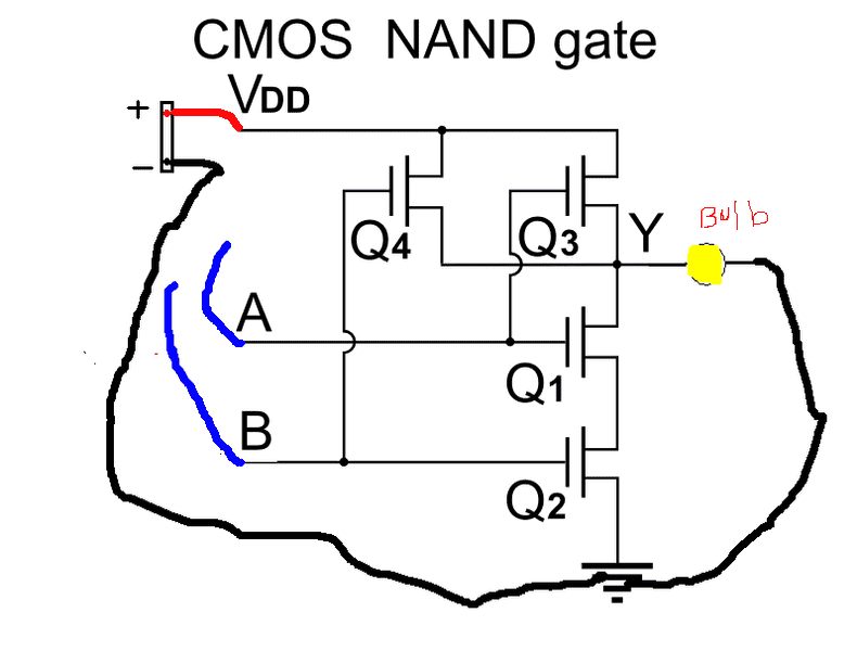

Here is a circuit diagram to maybe help you understand things a little better.
The voltages at A and B are controlled externally. Voltage at Vdd is always +5V (Assuming this is for a 5V CMOS). The symbol at the bottom right corner is the ground. It's always at 0V.
Now, Q1-Q4 are the Field Effect Transistors (FETs). Each FET has a line coming in from the left. That's the FET's gate. For the purpose of this discussion, think of each FET as a switch. Q1 and Q2 are normally open. You must apply high voltage (close to 5V) to the gate to close them. Q3 and Q4 are normally closed. High voltage on the gate opens them. (Keep in mind - closed switch conducts, opened switch doesn't. I know it might sound backwards.)
Now let's look at what happens when A and B are set to low/high voltages. If A is low, Q1 is open and Q3 is closed. So Y is connected to Vdd, and is therefore high. Similarly, if B is low, Q2 is open and Q4 is closed and Y is still connected to Vdd.
In order to disconnect Y from Vdd, you must apply high voltage to both A and B. That opens Q3 and Q4, also closing Q1 and Q2. So now, Y is connected to ground, and is low.In terms of logic operations, this is written as Y = A NAND B. It means that Y is true unless both A and B are true.
The interesting thing about NAND gates is that any other logic gate can be constructed out of combination of NAND gates, and that's actually what is done in modern CMOS chips.

I'm just trying to visualize how the circuit would look and how the battery connections would be made.
Is the ground connection (at 0 V) connected to the earth?
Please have a look on the attached diagram. I'm sure you could see what I'm trying to ask. How are battery terminals connected?

I would suggest taking a step back, and separating several ideas which are possibly confusing you.
first off, logic gates are an abstract idea. you should start by treating them as a black box whos output is a function of its input, and that function can be described using boolean algebra. a logic 1 is just a logic 1. it can be "5v" or "1.2v" or "true" or "yes" or "heads" or whatever. similarly, a logic 0 can be the opposite of all those things. "false" or "no" or "tails".
a logic gate is therefore just a process to identify a choice based on other things, and its used to build a complicated logical system from lots of simple logical choices.
now, the CMOS series of chips are just electrical circuits which follow the CMOS rules for defining what a logic "0" or "1" is. at this stage you really don't need to know about how the circuits operate, just how "CMOS" defines a logic 0 or 1.
remember, they need power, but that powersupply can be ignored when you consider the function of the chip.
finally, when you want to think about current and voltage and Fets and Power connections, you need a knowledge of analogue electronics.
if the chip is trying to provide a logic 1 on a pin, that voltage could be anywhere between the voltages specified on the datasheet. if its a CMOS chip, its guaranteed to follow the same set of rules as other CMOS chips, but the actual voltage and current will depend on the internal impedance of the pin, and the input impedance of the other chip, or whatever its interfacing with.
this is really quite a complex subject for a beginner, and I would not suggest trying to grab it all in one go. start with basic resistor networks.
on that diagram, VDD is the power supply, (connect the posative terminal of your battery here),
the triangle of lines at the bottom is "common" or earth. connect all negative terminals here. A and B are inputs, so connect them to switches which provide either 0v (ground) or VDD volts,
and Y is your output. measure with voltmetre? connect L.e.d to ground(earth)?

what don't you get about it? what are you trying to do with the diagram? the 1st battery and the bulb you have drawn on it are correct, connect the "?" marked ends to ground/earth/common.
the battery you have drawn connected to A and B is wrong. well, silly anyway.
you should connect a wire to each A and B, then touch those wires to either the +ve or the -ve terminal of the 1st battery. which connections make the bulb light up? there are four different connections you could make. have you seen the truth table for a nand gate?

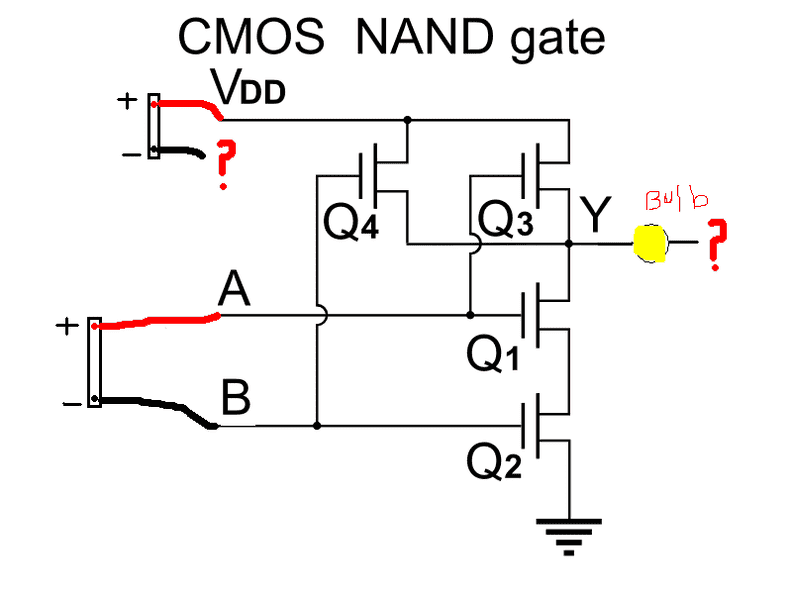

I have redrawn the diagram. Here is the truth table for NAND gate:
http://www.diracdelta.co.uk/science/source/t/r/truth table/image003.gif
The bulb would not light up only when both wires from A and B are connected to +ive terminal of the battery. Right?
When a wire from either of A or B is connected to the +ive terminal it is said it is at high voltage and when connected to -ive terminal it is at low voltage or zero voltage. Right? What would that state be called when the wire is not making a connection with any of the battery terminals? Please guide. Thanks.

thats right!
connecting a wire to the +ve terminal is applying a logic 1 to that input, and connecting it to ground you are applying a logic 0.
when two logic ones are applied to the input A and B, the output will be a logic 0, in this case 0v. since the bulb has 0v at both ends, no current flows through it and it does not light.
otherwise the output will be a logic 1, in this case, close to the voltage of your battery, and so the bulb lights as there is a potential across it.
when the wire is not connected to either terminal, its said to be floating or undefined. this is bad, since the actual voltage may vary depending on the environment or anything, and you cannot control the logic level on that input. the logic level could be labelled as Z, but that really doesn't apply here, since its only an input.
when you design circuits, you must take care that this doesn't happen. look into "pull-up" resistors, and "de-bounceing" of switches

I'm probably not the right person to expand on the red part, as I don't really know, but i'll give it a shot. and this is really an analogue question, so a fundamental understanding of current voltage and resistance is needed.
when you ask the question "whats the voltage at this point?" you are ultimately implying a reference voltage. you are really asking "whats the voltage between these two points?" but since its useful to chose one of those points to be 0v every time, you don't really need to specify it.
for there to be a voltage between two points, there has to be some electrical connection between those points, some potential which is applying a force to electrons. in the ideal model, the wire connected to the gate has zero resistance, and so must have the same potential all the way along it. and the gate of the Fet, or the base of the transistor is the only connection to that wire, but it is switched off, so there is no conductivity there. if there were some initial conditions where the wire had a charge, the Fet would turn on briefly, connecting the wire to ground, and depleting that charge. it would then remain off.
in real life however, only a tiny current is required to turn the transistor on, and the atmosphere is filled with EM fields. these EM fields can induce small potentials on the wire, causing the Fet to turn on. they would i think drain the charge and turn off again, but them it might happen again. what you could get is a rapid switching, causing the input to fluctuate very quickly between "1" and "0" and causing hell in your circuit.
