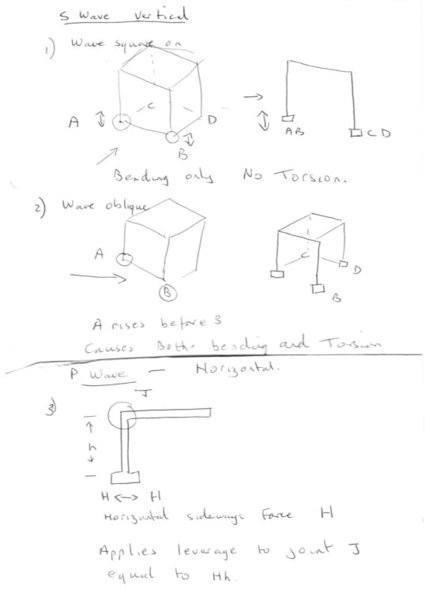

Studiot said:
The forces of an earthquake spread out from the source as two waves, one horizontal (P) wave and one vertical (S) wave.
These waves apply disturbing forces and movements to the building foundation points as the wave passes that particular point.
So if the building is a frame mounted on independent foundation pads or blocks the disturbance will occur at different times as the wave passes the individual pads.
this will introduce additional loading into the frame. You asked about torsion well torsion is bad because it can lead to very high stresses in directions the frame elements were not designed to be loaded and are thefore particularly weak.
Look at the sketch.
1) Is what happens when the wave arrives sqare-on ie parallel to the building grid.
As the wave passes AB at the front it lifts and drops the front pads and columns together so there is no side to dise twisting and no torsion.
So only additional bending forces aligned in the ordinary directions of the beams is introduced.
2) However there is only one direction paralle to the grid and many oblique to it so the wave is much more likely to arrive obliquely.
Immediately you can see that A is lifted before B (and CD_ so applies a twist to the frame as well as extra bending.
this is the dreaded torsion situation.
3) Shows the effect of the horizontal wave which moves the pads sideways. this applies a huge leverage on the joint at the top of the column.
It should be noted that the S and P waves travel at different speeds so arrive at different times unless the building is very close the the source.
