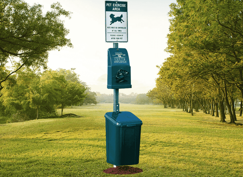

https://propetdistributors.com/wp-content/uploads/2016/02/1010.jpg
I think he wants to stuff used grocery store bags into the dispenser, then have people pull them out one at a time.
This simple device below does part of the job. But it is not protected from the elements or from animals. But you could maybe use it as a starting point.

Obviously, the KISS principle rules. Simpler is better. I think the problem is that the chance of having even one of those bags carry odors from spilled food is too high. The smell will drive squirrels crazy.

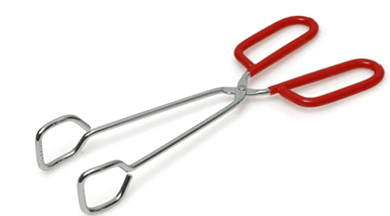

Instead of an opening big enough for a human hand, how about providing some tongs to pull the bag out?

Bears are unlikely to be a problem where I am but might be a problem elsewhere. However, yes, squirrels would be a bigger problem. That's why the flexible barrier exists. I don't like the idea of tongs, as they might disappear. It also seems needlessly complex.
