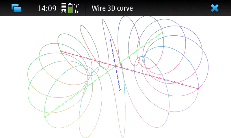

I use pocketCAS on the iPad and it seems to generate pretty smooth curves.
Can you tell us what surface you're trying to plot?
i'ts not a surface, it's a parametric curve. 3 independent functions, one for each dimension.
SciLab? It's like MatLab... but it's free. I love SciLab...
