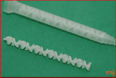

If they are just traveling down a straight pipe, the mixing will be slow. If that is okay for your application and you just want to quantify the (long) distance needed, I'll let others address that.
Instead, would it help your application to on-purpose encourage the mixing of the gasses to happen as soon as possible (as short a run of pipe as possible)? If so, you may be able to leverage some of the concepts for mixing liquids (like 2-part epoxies). See this previous PF thread for more information on that:
