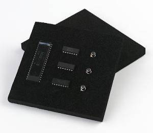

How about just starting with ESD anti-static foam? It's not real conductive (100kOhm/square?), but it might be available in different conductivity ranges...
http://image.made-in-china.com/43f34j00pZPEGSHdnKbl/Antistatic-Foam-ESD-IXPE-Foams-Packing-Foam.jpg
