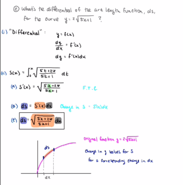

Please see the attached image. It's a part of a study guide for my final, but I didn't put it in the homework section because I already got the answer, I just don't know what it means.
The question has to do with the differential of an arc length. I made some drawings to see if I could make some sense out of it but I don't think I'm quite there.
So when we're talking about the differential of an arc length, what exactly does this mean?

##d\vec s=dx~\hat i+dy~\hat j##
##ds =\sqrt{d\vec s \cdot d\vec s}=\sqrt{(dx)^2+(dy)^2}=dx\sqrt{1+(\frac{dy}{dx})^2}##

Sorry, I thought you understood vectors. Yes, it has to do with the Pythagorean theorem. A two dimensional displacement ##ds## has a horizontal part ##dx## and a vertical part ##dy##. The two form a right triangle and ##ds=\sqrt{(dx)^2+(dy)^2}## is the hypotenuse.

So then, since our ##dx## is extremely small, we can pretty much say that the curve of the graph is a straight line in that ##dx##.
This would give us a right triangle with the base as ##dx##, the hypotenuse as ##ds##, and the side length as what? It would have to be the change in y values corresponding the the change in x values (##dx##), but in terms of notation, what would this be?
Look at post #2. If ##ds =dx\sqrt{1+(\frac{dy}{dx})^2}##, what is ##ds## when ##y=2\sqrt{5x+1}?##
##ds=dx\sqrt{\frac{5x+26}{5x+1}}##?
Right. Does this answer your original question or is there more to it?

ds represents an infinitesimal change in the length along the curve. This length depends on both dx and dy, not just dx.
The formula for s(x) that you show is not a general formula for arc length. This integral comes from the general formula for arc length, in which ds is defined as the hypotenuse on a right triangle whose legs are dx and dy.
Here's a picture.
So ##ds^2 = dx^s + dy^2##, or ##ds = \sqrt{dx^s + dy^2}##. This latter equation can take different forms, using algebraic manipulations. One form is ##ds = \sqrt{1 + \left(\frac{dy}{dx}\right)^2}~dx##, if y is given as a function of x. Another form has ##1 + \left( \frac{dx}{dy}\right)^2## inside the radical, for when x is given as a function of y.
