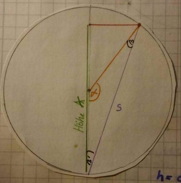

Now I thought: Hey, why not write h so that it is dependent on the angle α. But that turned out to be way more difficult than I thought ... and I am sure I didn't do it right but here it goes:
On the picture "Idea" it's kinda explained:
The heigth of the object is always a part of 2r. So if I drew a straight line from the point the object is on the loop/circle and let it intersect, the actual height of the object would be that part of the 2r. I used the idea that the angle α could create a segmentline s between the startpoint and the current location of the object. Wikipedia said the length of a segment is calculated with s = 2 * r * sin(α/2). But the length of the segment only gives me a part of the height so I used trigonometry to calculate the green height using the angle β. I thought since the triangle the radius and s is a isosceles triangle, the other two angles besides α are ought to be the same. If they are, one of them could be calculated by:
β = (180° - α) / 2​
By using trigonometry, I found out that the height of the object should generally be:
h = cos(β) * s​
Putting it all together, the formula for my height would be:
h = cos((180°-α)/2) * 2 * r * sin(α/2)
And now all there is left is putting it in the formula for the velocity I derived above, which results in:
v(α) = √( vu2 - 2 * g * cos((180°-α)/2) * 2 * r * sin(α/2) )
That's a very long formula if you ask me and somehow I don't believe it to be right.
In order to calculate whether or not the object passes through the highest point of the loop (at α=180°), Fzp ≥ Fg which means v(180°) ≥ √(r * g)
If I put everything in the formula, v(180°) = 22.81 m/s which seems legit enough.
√(15 m * 9.81 m/s2 ) = 12.13 m/s which means that the object should pass through the highest position.
Could someone please help me solve the question and correct me where I got wrong. I'd be so grateful for every help.

Your expression for the height is too complicated and wrong. Since height is arbitrary, you can just set the zero of height to the be center of the circle.
No, it's correct, but it is much more complicated than it needs to be.

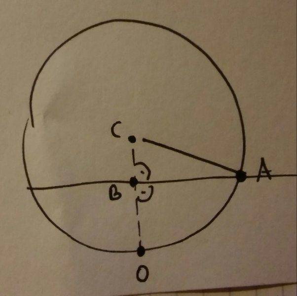

@Indira_Clueless , go back to the original diagram and draw a horizontal line from the position of the cage to the vertical dashed line. How far is it from that intersection to the circle's centre?

Well I'll be damned. :oops:. I thought it was wrong because I would never have thought to calculate it that way.

Let me label some points. C is centre of circle, O is bottom of circle, A is current position of cage.
Horizontal line from A intersects OC at B.
OC=AC=r.
You know angle BCA. Study triangle ABC.
How long is BC?
What do you get for height if you set the zero point in the center of the circle?
Now just take that result and add the height of the center of the circle.

well I guess the length of BC would be √(CA2 - BA2) ?
I mean, if I got you correctly ...
/Edit: Which means the height would be r - BC ... right?

Yes, but use the known angle BCA (=alpha) and the known distance AC=r.

BC = cos (α) * r then, if my trigonometry doesn't fail me.

Right. So the height of the cage (OB) equals...?
The height of OB would equal r - BC = r - cos(α) * r which you could also write as r * (1 - cos(α))

That's it.
Likes Indira_Clueless
And r * (1 - cos(α)) is equal to your earlier complicated expression.
