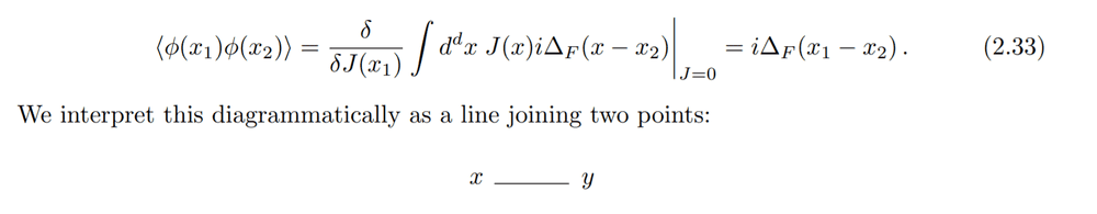

My understanding of the n-correlation function is
\begin{equation*}
\langle \phi(x_1) \phi(x_2) ... \phi(x_n)\rangle = i \Delta_F (x_1-x_2-...-x_n)
\end{equation*}
Where ##\Delta_F## is known as the Feynman propagator (in Mathematics is better known as Green's function).
Let us analyze ##\langle \phi(x_1) \phi(x_2) \rangle## first. Conventionally, the ##\Delta_F(x_1−x_2)## propagator is drawn as a line

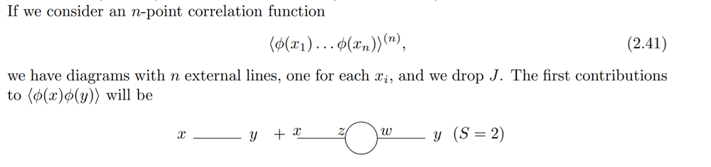

OK. But then I see that the second contribution is given by a diagram with a 'bubble' in between, with a symmetry factor of ##2## attached to it
Regarding the symmetry factor ##S=2## attached to the bubble diagram.
This is how I approached it (highly inspired by the accepted answer here) : Let's start with the external leg on the left. There are two possibilities for this external leg to attach: it can attach to either ##z## or ##w##. The right external leg is thus left with only one possibility. Hence we have a ##2 \times 1## factor. We could start from right to left instead so, by the same token, we pick up another ##2 \times 1## factor. The upper internal leg can either attach to ##z## or ##w## while the lower is left with one option only; we hence pick up a ##2 \times 1## factor. We could start with the lower internal leg instead so, by the same token, we pick up another ##2 \times 1## factor (still thinking about the argument used for the internal legs...).
Overall, the Dyson series gives us a ##1/2!## factor and the two vertices give ##1/(2!2!)## so the symmetry factor I get is
$$\frac{2\times 1 \times 2\times 1 \times 2\times 1 \times 2\times 1}{2!2!2!}=2$$

1) Why does this 'bubble' contribution emerge?
2) What are the specific Feynman rules that allow us to write down all contributions?

Somehow the time-ordering symbol is missing. The Feynman diagrams are just a very clever notation to evaluate the functional derivatives wrt. the external source ##J(x)## or, equivalently, the application of the Wick theorem to evaluate vacuum expectation values of time-ordered field-operator products in the operator formalism. In this way you can also find a safe way to get the symmetry factors. For you one-loop contribution of the four-point function you start with drawing the two three-leg vertices and the two external points. Now you count in how many ways you connect these elements to the diagram of the given topology: for the first external point you have 6 possibilities to connect it with one of the legs. For the 2nd external point you have 3 remaining possibilities. Then you have 2 possibilities to connect one of the legs of one vertex with one of the other. The remaining connection is then unique. So the overall factor is 6*3*2/(3! 3! 2)=1/2.
