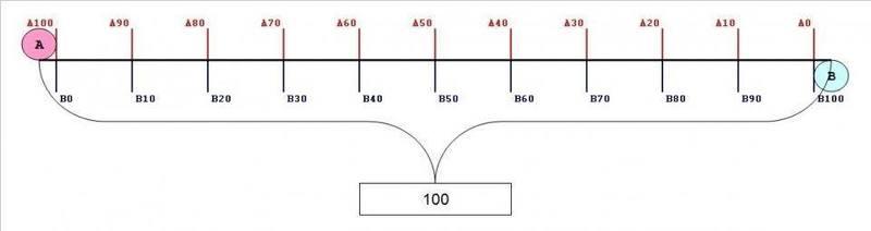

Two probes A and B.
Clocks are synchorized.
Distance is 100 Ly.
Each year they're sending digital signal, containing their respective time.
A will send A0, A1, A2, A3 for each respective year.
B also send B0, B1, B2,... each year.
Signal from B is always late for 100 years
So each year A will receive:
Code:
Signal   A Time      Interval
B0       100.00
B1       101.00      1.00 year
B2       102.00      1.00 year
B98      198.00
B99      199.00      1.00 year
B100     200.00      1.00 year
Is this true?

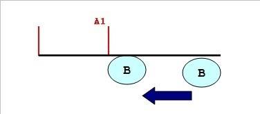

How will B PICK UP signal from A?
From where B stays and A1 there's 1 ly
B travels at Vb
Vb.t + ct = 1 ly, if Vb is relative to c, then c = 1
Vb.t + t = 1
##t = \frac{1}{1+V_b}/\gamma##
t = 0.27
Is this true?
Code:
Signal B Time  Interval
A0     100.00
A1     100.27  0.27
A2     100.54  0.27
A212   156.81  0.27
A213   157.07  0.27
A214   157.34  0.27
A215   157.61  0.27 B meets A

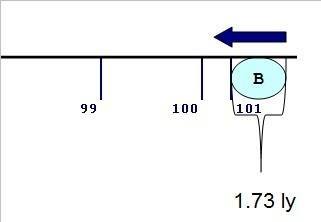

How will A receive signal from B?
B is still sending signal.
Signal B101 is not sent 100 lys from A because B is moving.
Signal B101 is sent at Vb.t distance
Signal B101 should be sent at (100-0.86) ly from A. Because ##\gamma = 2##, so B101 is sent at 98.27 ly from A. Is this true?
B01 will be picked by A after 102 years, not 101 years, because 1 year for B is 2 years for A
So B101 will be received by A when Ta is 102 + 98.27 = 200.27. Is this true?
Code:
B0       100.00      when A received B0, A still doesn't know that B has
                     already traveled.
B1       101.00      1.00 year A still doesn't know that B has moved
B2       102.00      1.00
B98      198.00
B99      199.00      1.00   Still doesn't know
B100     200.00      1.00   Stil doesn't know
B101     200.27      0.27   Suddenly A begins receiving signals at 0.27
                            years interval
B102     200.54      0.27   Is this true?
B103     200.80      0.27
B155     214.74      0.27
B156     215.01      0.27
B157     215.27      0.27 B meets A
Is the table above is true?

Two probes A and B.
Distance is 100 Ly.
You didn't mention the frame. I assume it's the common frame shared by A and B. It's good to get into the habbit of specifying the frame, because it matters in SR. Typically when you don't mention something, it reflects an underling thought process that hasn't quite accepted the fact that the choice of frame DOES matter, which leads inevitably to confusion.
Code:
B0       100.00
B1       101.00      1.00 year
B2       102.00      1.00 year
B98      198.00
Is this true?
Yes

B will receive a signal from A every ##\gamma(1-v/c)## years as per wiki. There are several alternate equivalent formulae. I get this as a period of .2679 years, close to your figure.
B travels at Vb
Vb.t + t = 1
t = 0.27
Is this true?
I'm not following this, sorry. It's not what I'm getting, either. So it's probably not true.
A will send out a total of 216 plus a fraction signals that B will receive, the first signal A0 will be received by B when B starts the trip at B's time of 100. (Note that the set {0,1,...,215} contains 216 elements.) The first signal is numbered A0, the last A215. The spacing between signals is .2679 years. The last signal from A, A215, will be received at a time of 215*.2679 = 57.6 years according to B's clock, near the end of B's trip.
B will send out a total of 58 signals on the trip, the first signal B100, the last signal B157. A will receive the first signal, B100, at 200 years on A's clock due to propagation delays, the same time at which A will see B's rocket flare through a telescope (if A is looking).
A will receive signals from that point at the rate of 1 signal every .2679 years, so the last signal, B57, will arrive at 200+.269*57 = 215.27 on A's clock, shortly before B arrives.
