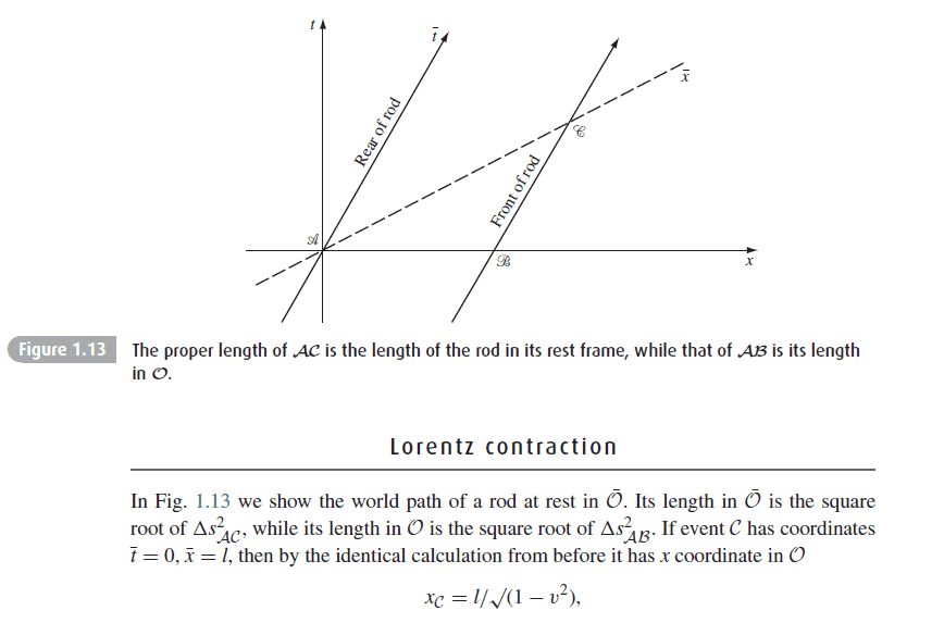

Hello, i can't understand how does the author found this expression relating ##x_{c}## and v. I already tried by a lot of geometrical ways, knowing that the tangent of the angle between the dotted line and the x-axis should be v, but the results are illogical. Could you help me? I am start to thinking it is a postulate ...

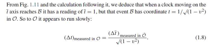

But he derive the Lorentz transformation after this, before it there is just the time dilatation:
The figure he cites is another figure, but at least this expression for the time i could found using the interval invariance ds². For the length contraction, i can't see how he deduced it. And i don't want to use the interval invariance again, i am trying to gain some insights using just the graphic.

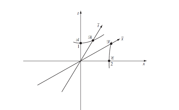

That's the image for the time dilatation, the curves in the graph are hyperbolae.

I think what you are supposed to do is note that ##\mathcal{C}## lies on an invariant hyperbola (see the curve ##\mathcal{EF}## in Figure 1.11) that satisfies ##-t^2+x^2=l^2## (section 1.7). You also note that the ##\bar{x}## axis is the line ##t=vx## and solve simultaneously for ##x## and ##t##.

Say angle between t axis and ##\bar{t}## axis ##\theta##, law of sines on triangle ABC says
[tex]\frac{AC}{sin(\frac{\pi}{2}+\theta)}=\frac{AB}{sin(\frac{\pi}{2}-2\theta)}[/tex]
[tex]AB=\frac{\cos 2\theta}{\cos\theta}AC=\frac{\cos^2\theta-sin^2\theta}{\cos\theta}AC[/tex]
Magic : sin and cos are replaced by sinh and cosh,
where ##\tanh \theta=v## where c=1
[tex]AB=\sqrt{1-v^2}AC [/tex]
