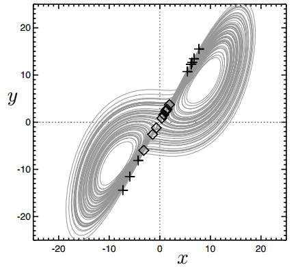

The figure below shows the path of a particle governed by the Lorenz equations with r = 28, σ = 10, b = 8/3. The x'es and boxes show points where the path crosses the plane z = r − 2σ > 0.
(a) Which indicator shows a decreasing z and which shows an increasing z?

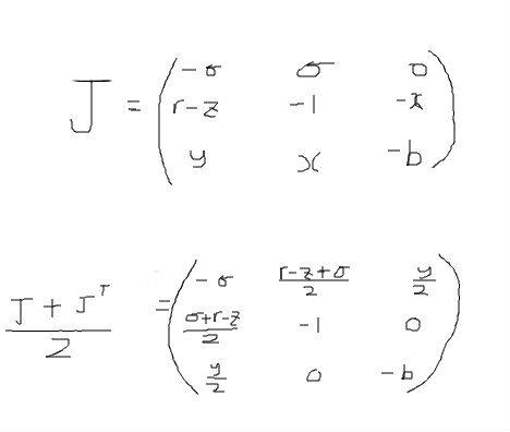

(c) Find ##\frac{J + J^T}{2}## and its eigenvalues at (0, 0, r-2σ). Hence deduce that of ##\delta x ## grows is in the x-y plane while it decays is along the direction of z-axis.

Part (a)
[/B]
For ## \dot z < 0##, ##xy < bz \approx 21##.
So the boxes represent decreasing z, the x'es represent increasing z.

The matrix ##\frac{J + J^T}{2}## becomes:
I found the eigenvalues to be:
[tex]\lambda_{1,2} = -\frac{ -(\sigma + 1) \pm \sqrt{ (\sigma+1)^2 - 4(\sigma - \frac{9}{4} \sigma^2) } }{2} [/tex]
[tex]\lambda_3 = -b[/tex]
