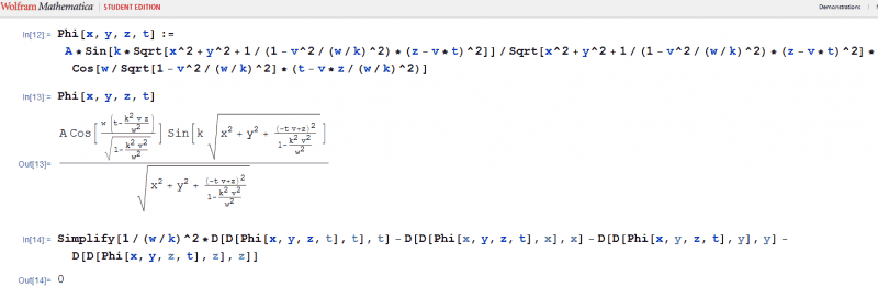

I calculated this with Mathematica. I would have uploaded the notebook, but I can't.
Hence I made a screenshot. You can calculate this easily with any program of your choice.
Just replace c with w/k.

[tex] \Phi = A\frac{\sin(k\sqrt{x^2+y^2+(\gamma(z-vt))^2})}{\sqrt{x^2+y^2+(\gamma(z-vt))^2}}\cos(w\gamma(t-\frac{vz}{c^2}) [/tex]
is a solution of the wave equation. v is the velocity of the 'standing' spherical wave, relative to the e.g. ideal gas.
Both space and time are transformed. The spherical standing wave carries 0 momentum in the old frame and a momentum in z-direction in the new one.
