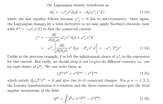

Please let me attach an image of the rest of the example I want to comment:
From here I basically do not get the following:
- I do not get the last equality on 1.53 (i.e. why the last equality follows because ##\omega^{\mu}_{\mu}=0##; I do not see the antysimmetry argument).
- I do not see neither how to get 1.55 nor ##\partial_{\mu}(J^{\mu})^{\rho \sigma} = 0##
$$\partial_{\mu} ({\omega^{\mu}}_{\nu} x^{\nu} \mathcal{L}) = {\omega^{\mu}_{\nu}}(\delta_{\mu}^{\nu} \mathcal{L} + x^{\nu} \partial_{\mu} \mathcal{L})={\omega^{\mu}_{\nu}}x^{\nu} \partial_{\mu} \mathcal{L},$$
because due to the antisymmetry of ##\omega^{\alpha \beta}## as well ass the symmetry of ##\eta_{\mu \nu}##
$${\omega^{\mu}_{\nu}}\delta_{\mu}^{\nu} =\omega^{\mu \nu} \eta_{\mu \nu} = \frac{1}{2} (\omega^{\mu \nu} - \omega^{\nu \mu}) \eta_{\mu \nu} = \eta_{\mu \nu} \omega^{\mu \nu} - \omega^{\nu \mu} \eta_{\nu \mu} = 0.$$
Noether's theorem tells you that (1.55) is conserved, but you want to get rid of the matrix ##\omega##. But the matrix ##\omega## can be arbitrarily chosen under the constraint that ##\omega_{\mu \nu}## is antisymmetric. So we rewrite the current a bit
$$j^{\mu} = -\omega_{\rho \nu} T^{\mu \rho} x^{\nu}=-\frac{1}{2} \omega_{\rho \nu} (T^{\mu \rho} x^{\nu} - T^{\mu \nu} x^{\rho}).$$
Now you can put for ##\omega_{\rho \nu}## all antisymmetric matrices, thus ##\partial_{\mu} j^{\mu}=0## implies that the ##(\mathcal{J}^{\mu})^{\rho \sigma}## are indeed 6 independent conserved currents, ##\partial_{\mu} (\mathcal{J}^{\mu})^{\rho \sigma}=0##.
I hope this helps a bit further.

Here's my issue now: I do not see why the following holds
$$\partial_{\mu} ({\omega^{\mu}}_{\nu} x^{\nu} \mathcal{L}) = {\omega^{\mu}_{\nu}}(\delta_{\mu}^{\nu} \mathcal{L} + x^{\nu} \partial_{\mu} \mathcal{L})$$
I would expect instead to have the following
$$\partial_{\mu} ({\omega^{\mu}}_{\nu} x^{\nu} \mathcal{L}) = \omega^{\mu}_{\nu} x^{\nu} \partial_{\mu} \mathcal{L}$$
Thus, what I do not see is why the term ##\omega^{\mu}_{\nu}\delta_{\mu}^{\nu} \mathcal{L}## arises.
It's from the product rule and
$$\partial_{\mu} x^{\nu} = \delta_{\mu}^{\nu}.$$
Likes JD_PM
Ahh sorry Sr, I see it now! Thank you again.
I forgot that
$$\partial_{\mu} x^{\nu} = \frac{\partial x^{\nu}}{\partial x^{\mu}} = \delta_{\mu}^{\nu}.$$
