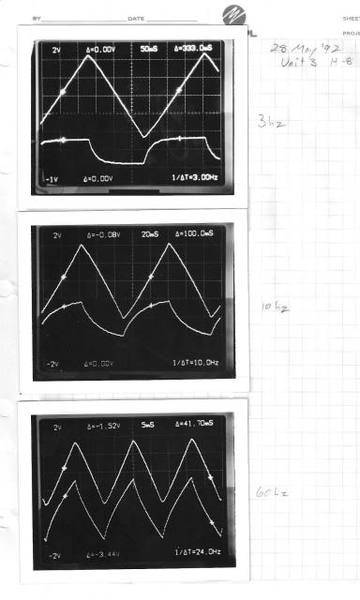

I once experimented with twelve foot long solenoids where of course flux is lower than a closed transformer core.
We excited the solenoid with a triangle wave current so the e = k*di/dt relationship would be apparent.
Triangle wave is constant di/dt on each slope so we expect square wave voltage.
What we observed is the "retardation of magnetization" due to eddy currents makes this solenoid resemble inductance at low frequency only.
Traces of excitation current(upper trace) and induced voltage(lower trace) at three different frequencies.
Top traces at 3 hz
middle traces at 10 hz
bottom traces at 60 hz.
As you see voltage got bigger with increased frequency but the waveform was no longer the expected square wave.
Even at 3 hz the time for eddy currents to settle is apparent- the slow rise and fall times of the square wave is tens of milliseconds.
Those traces are from a control rod position sensor.
It has a moveable core of 400 series stainless steel which is ferromagnetic. The rod is near full out, ie magnetic core is most of the way up in the solenoid.
But with air core(rod on bottom) the waveforms looked textbook - triangle current, square wave voltage..
Clearly when we inserted the core our excitation current (triangle wave) was no longer the only current flowing.. Eddy currents delayed its magnetization.

Yes, that's a measurement of a control rod position detector taken from the control room.
It's an open coil surrounding the shaft that lifts the rod.
The shaft is inside a non-magnetic pressure boundary, the coil surrounds both..
The shaft is a solid rod perhaps two inches diameter.
The coil has a few thousand turns.
Excitation current was about 20 milliamps.
The device is intended to detect position of the shaft.
If you think about it in simplest terms, in a long solenoid half the magnetic circuit is outside the coil and half inside.
So as you insert a highly permeable core, you are replacing half the magnetic path with essentially a short-circuit for flux. So when core is fully inserted flux should double and we observed not far from that.
At DC the relative permeability of ferromagnetic iron is at least in the hundreds.
But with AC, eddy currents cancel magnetizing amp-turns per Lenz's law.
So with AC it's as if the relative permeability were much lower than the DC value in the catalogs.
This core's material listed a relative permeability in the range of several hundred.
But at 60 hz we observed an effective relative permeability of more like 20.
At three hz it was around 100.
At 400 hz our coil was oblivious to presence of the core - effective relative permeability of ~1.
We attributed this to its not being laminated.
And it showed a significant temperature dependence which is what we were investigating in the first place. Not surprising in hindsight, for temperature directly affects conductivity of iron which is a major term in that NASA paper.
