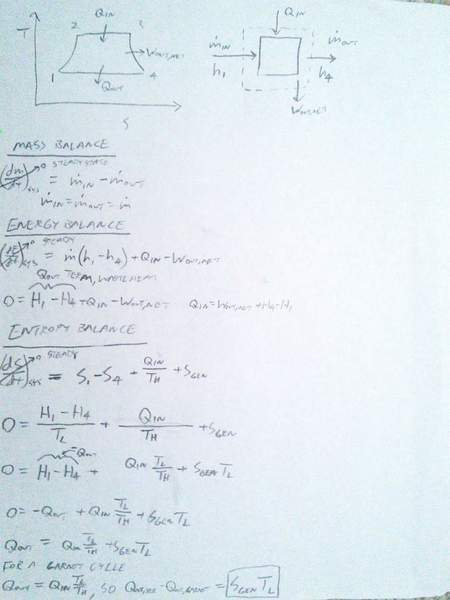

Okay, I obsessed over it but I think I found the answer. Assuming two isothermal reservoirs, I believe the work lost to be this:
[itex]W_{lost}=S_{GEN}T_{LOW}[/itex]
I can take you through the derivation if you need, but I'm going to bed for the night so it will have to wait until tomorrow.

That is correct. However, if you take a Carnot cycle, replace the isentropic processes with processes that increase the entropy, and calculate the loss in energy due to the entropy increase, you should end up with S_gen*T_low, where T_low is also referred to as the dead state temperature (I think). I will try to post some of the derivations if I get a chance.
Here's the derivation, I tried some of the other ones and they were too hard for me to be confident that I did them right (like the finite source and sink).
Anyway, here's the derivation and hope it helps a bit.
