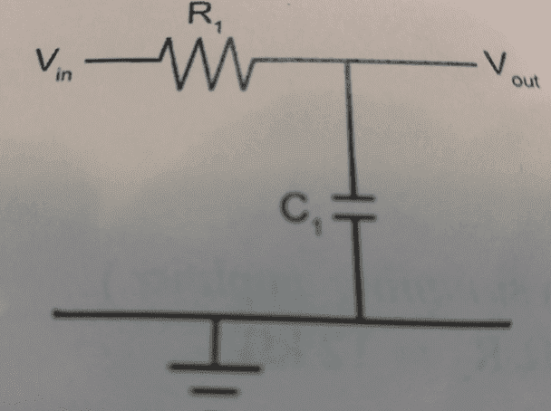

(a) If R1 = 4.7kΩ, what value for C1 will give a cutoff frequency of 50kHz?
(b) If the input voltage is described by the equation Vin = 3cos(2π(4000)t), what will the peak output voltage be?[/B]
(a) fc = 1/(2πRC)
(b) Vout/Vin = 1/√(1 + (2πfRC)2)
(a) I rearranged the equation to C = 1/(2πfcR). I got 71.2 pF but am uncertain.
(b) Not sure if this is the relevant equation. If it is, than I am uncertain how to get the frequency of the input voltage.

(a) I rechecked my work and got 677.3 pF
(b) So if without the low pass filter the peak voltage would be 3V. Would the frequency be 2π4000 = 25132.7? What about phase? If I'm assuming the values from part (a), then wouldn't the output voltage match the input voltage as 25.1 kHz < 50kHz and this is a low pass filter? If this is wrong and the frequency is really higher than the cutoff, I know that output lessens as frequency increases, but I'm not sure of the equation that would give me the voltage output.

Ah right, so the frequency is simply 4 kHz, which means Vout would be approximately equal to Vin.
Yes - approximately. However, do you think this answers the queston? Why not do an exact calculation?

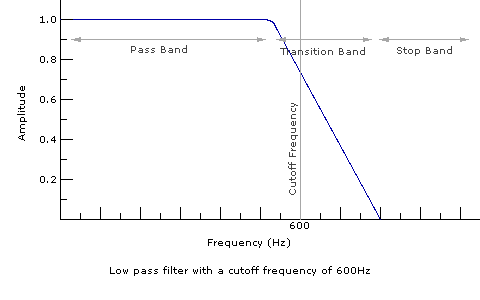

Well, I don't know how to do the calculation. This graph makes is seem as though they'd be exactly equivalent:
No - it`s impossible. Because at 4 kHz the capacitor has an impedance other than infinite, you have a (small) voltage division between R and C.
In addition, there is a (small) phase shift, Thus, you have to use the complex transfer function for separately calculating magnitude and phase.
Don`t you remember - in your first post you have given already the correct magnitude expression. Insert the frequency - and you have the result.
(Remark: The shown graph is not very realistic for a first-order lowpass)
