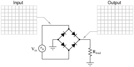

Wouldn't it be better to understand how it's done in the real world instead of killing yourself? Do you know how a bridge rectifier works? If not, it's fairly simple as this image shows:
Image compliments of http://educypedia.karadimov.info/electronics/javaanalogsemipassif.htm

What is the safe way? Can I put transformer between AC and circuit so it will step down voltage?
Thanks for the image!

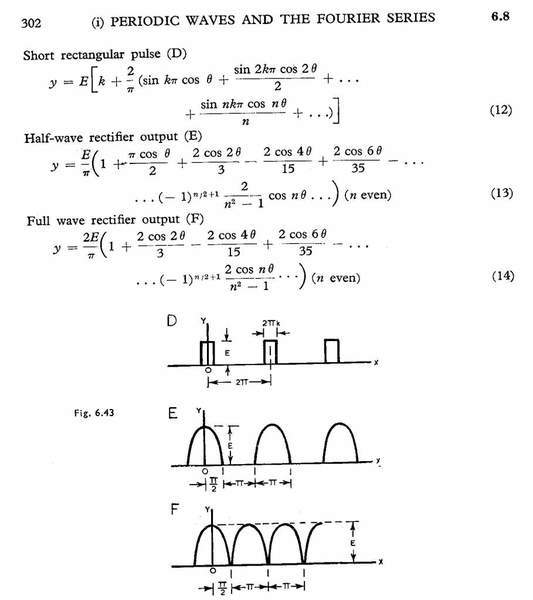

Not quite.
A full-wave rectifier is a frequency doubler. There would be no 60Hz fundamental to remove with a notch filter.
A full-wave rectifier would generate a DC offset, with a 120Hz fundamental and many harmonics of 120Hz. If you removed the 120Hz fundamental you would be left with DC plus many even harmonics of the missing 120Hz fundamental.
A half-wave rectifier would produce a DC offset, with a 60Hz fundamental and many harmonics.
@Baluncore
You are absolutely correct of course. I was intentially being overly simplistic and ventured into WRONG. I didn't want to get into power supply filters, And I added the full wave as a simple correction after noticing that .707 was wrong for half wave.
