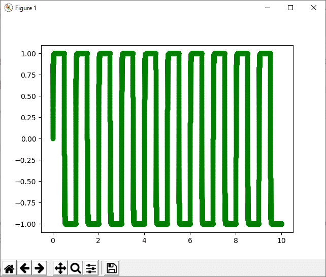

In summary, your code produces three plots that simulate something. It looks as if it does so correctly. It would be nice if there was a way to automate that.

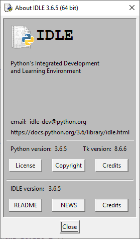

Your code runs just fine :
This is on W10 with IDLE:

When is code 'true' ? Your script produces three plots that simulate something. It looks as if it does so correctly.
So for you , the thing to do is try and grasp the subject matter -- as opposed to polishing up the simulation :wink:
Maybe even do (on paper) a calculation of what you expect to see :biggrin:
