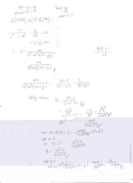

I understand SinWt = iR + iC
Then i applied laplace : W/(s^2+w^2) = IR + IC.
Is this correct?
Cfty said:
I can't understand. Argh.kNot so good in this.
Is this correct?
sin(wt) = iR + iC is not correct. R and C are not the same type of impedance!
But you got the right transform for sin(wt).
I tried it with W/(S^2 + W^2) = IR + I/CS
Do i need to diffrentiate anywhere in this question?. I got the first two parts for the showing right. I can't seem to get the final part. I followed the laplace transform on top by making I the subject and doing partial fractions. Then when i found I i laplace inversed it to Find i. And Since Vout is VR : i took the i*R.
This is correct
No.
That is correct.
Yes, if I understand you correctly, Vout= iR.
Show your math in detail.

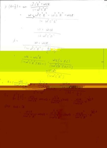

Hey This is my written solutions. If you could tell me where i went wrong I would greatly appreciate it.

rude man said:
This is correct
Hope It helps
Your equation at the top of page 1 is correct. And your answer is almost correct, obviously.
You just made an algebraic mistake somewhere. You can see that the last term in your answer is incorrect since it's dimensionally incorrect. Each term must be dimensionless
(actually it's Volts but you didn't include volts in your excitation function).
I can't follow your math from the pictures. I will leave it to you to find the mistake you made.
Good luck and good work!
