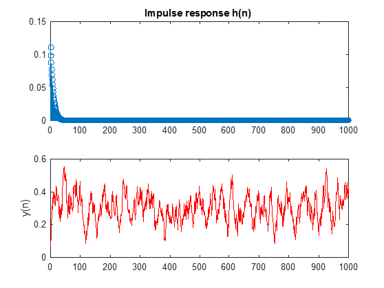

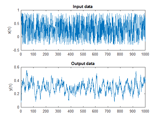

So then I tested few things in Matlab:
Code:
clear all, clc
n=1000;
x = -0.3 + (0.9-(-0.3)).*rand(n,1);
y = filter(0.111,[1 -0.889],x);
figure(1)
subplot(211)
plot(x)
title('Input data')
ylabel('x(n)')
subplot(212)
plot(y)
title('Output data')
ylabel('y(n)')
figure(2)
subplot(211)
hist(x,24)
title('Input data histogram')
subplot(212)
hist(y,24)
title('Output data histogram')
figure(3)
a=[1, -0.889];
b=[0.111];
[h,t]=impz(b,a,1000);
subplot(211)
stem(t,h);
title('Impulse response h(n)')
subplot(212)
y1=conv(h,x)
plot(y,'-r')
ylabel('y(n)')
And this is result with convolution formula:
There I tested that I can get same results with convolution formula and orginal filter formula. Is there all OK?
But I guess that is not what I exactly need to explain output distribution. As I understand your hints, I need to do convolution operation with two different distribution functions.

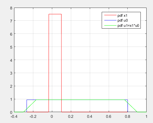

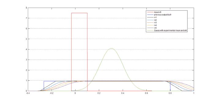

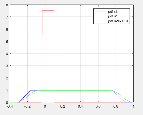

Input distribution:
$$f_x =
\begin{cases}
0, & x \lt -0.3 \\
\frac {1} {1.2}, & -0.3 \leq x \leq 0.9 \\
0, & x \gt 0.9
\end{cases}$$
Input distribution scaled by ##1/9##::
$$f_{x/9} =
\begin{cases}
0, & x \lt -\frac {1} {30} \\
7.5, & -\frac {1} {30} \leq x \leq 0.1 \\
0, & x \gt 0.1
\end{cases}$$
Filter's previous output scaled by ##8/9##:
$$f_{8u_{0}/9} =
\begin{cases}
0, & x \lt -\frac {4} {135} \\
8\frac {7} {16}, & -\frac {4} {135} \leq x \leq \frac {4} {45} \\
0, & x \gt \frac {4} {45}
\end{cases}$$
Then I need to calculate:
$$f_{u_{n}}(z) = \int_{\infty}^{-\infty} f_{8u_{n-1}/9}(x) f_{x/9}(z-x) \, dx$$
First iteration n=1:
$$f_{u_{1}}(z) = \int_{\infty}^{-\infty} f_{8u_{0}/9}(x) f_{x/9}(z-x) \, dx$$
But I have got 1000 random numbers (input), is it mean that to calculate resulting PDF I need to do n=1000 iterations? :confused::oldconfused:

Good work so far! :smile:
Before we go on though, I must ask: were you really tasked with finding the actual (mathematically exact) probability density function?
In your original post, the question was asking for a reason why the filter's output's probability density function looked Gaussian (or at least Gaussian-like) when the input's probability density function was uniform.
I ask because I think you are very close to being able to answer

Then I tried to solve few discrete convolution iterations in Matlab. Here are results:
Something looks incorrect there.. Of course, I can see how from two uniform distributions, sum of distributions starts to look like Gaussian. But values seems incorrect.
Green line is Gaussian pdf with experimental mean and std from here (output data histogram):
I think (and actually you said it) when n goes to infinity (or even as it is in my case n = 1000), my output pdf should be simular like that Gaussian pdf, but in my case amplitude is about value 1, which is not close to Gaussian max amplitude value (4). I guess, ##f_{8u_{0}/9}## is wrong.
It's late now, I will chek it tomorrow one more time. And I think it will be OK without mathematically exact output probability density function to prove output. Graphic with iterations shows very well how convolution works and how sum of distributions starts to look like Gaussian. Just need to correct values there, I guess.
I went through my calculations.

Matlab code:
Code:
clear all, clc
T=0.001;
t=-0.267:T:0.801;
t2=-0.267*2:T:0.801*2
x1=7.5*(t>-1/30) - 7.5*(t>0.1);
x11=7.5*(t2>-1/30) - 7.5*(t2>0.1);
u0=0.9375*(t>-4/15) - 0.9375*(t>0.8);
u1=T*conv(u0,x1);
figure(1)
plot(t,x1,'red',t,u0,'blue')
hold on
plot((-0.267*2):T:(0.801*2),u1,'green')
grid on
xlim([-0.4 1])
legend('pdf x1','pdf u0','pdf u1=x1*u0')
u2=T*conv(u1,x11);
figure(2)
plot(t2,x11,'red',t2,u1,'blue')
hold on
plot((-0.267*2*2):T:(0.801*2*2),u2,'green')
grid on
xlim([-0.4 1])
legend('pdf x1','pdf u1','pdf u2=x1*u1')
n=1
##f_{u[1]} = f_{8 u[0]/9} \ast f_{x/9}##
n=2
##f_{u[2]} = f_{8 u[1]/9} \ast f_{x/9}##
And now, writing this post, I realized where's my mistake.. I didn't scale ##f_{u[1]}##. I used ##f_{u[1]}## in n=2, but I need ##f_{8 u[1]/9}##. Ehhh..
