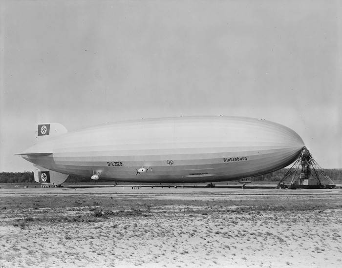

The Germans used gas bags like this for storing their low pressure hydrogen:

The gas bags of older airships were made from several layers of goldbeater's skin folded together to give an impermeable membrane. Goldbeater's skin is made from the outer layer of a calf's intestine, so one airship requires making a lot of veal, which comes in handy when your national cuisine prizes wiener schnitzel. :smile:
But, times and technology change, and by the 1920s, goldbeater's skin had been displaced in airship construction by a synthetic material developed in the USA by the Goodyear company. As a result, good veal has been hard to find in the USA ever since, unless you have a suit with a monsignor's stripe on it, as claimed by father Guido Sarducci. :wink:
The material Goodyear developed was called gelatinized latex, and the outer skin of the airship was made reflective so that infrared and UV radiation would not damage the gas bag materials inside.
https://en.wikipedia.org/wiki/LZ_129_Hindenburg
