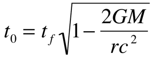

To be exact all relevant experiments including Pound-Rebka have confirmed this equotation (simplified version for Schwarzschild metric):
In line with GR this is interpreted as confirmation of gravitational potential related to time dilation, but to be precise these experiments were all done above surface and did not disprove possibility that this equotation is valid only for r above surface. I am not saying that it is valid only for above surface, because this is not in line with current mainstream interpretation of GR and it would be just a speculation. What I am saying is what exactly is confirmed and what is not confirmed by experiments.
That is true.
However, the experiments already done above the surface do disprove the possibility that the time dilation is due to the gravitational acceleration. So regardless of if the GR equation is valid below the surface, the gravitational acceleration concept is not valid even above.
It is only valid for ##r## above the surface. Below the surface the equation for gravitational time dilation is different. The equation you wrote down is only valid in the vacuum region outside the massive body; it's not valid inside the body.

Just to be precise: the dependence of the potential on ##r## is different in the interior of the Earth, i.e., when surrounded by matter. But the fact that gravitational time dilation depends on the potential, not the "force" of gravity, does not change. (AFAIK experiments have not tested this to any great depth in the interior of the Earth, because of the obvious difficulties involved.)
Dalespam said the following but I think you didn't get it. This formula is for potential, not force. Take the Taylor expansion and it is 1/r not 1/r2. If time dilation were proportional to change in acceleration, then Pound-Rebka could never have detected it - the effect would be orders of magnitude too small. Instead, time dilation was effectively proportional to g*h, with g constant. This was really a test of the principle of equivalence - that difference in position in an effectively static field was equivalent to difference in position in a similar height accelerating rocket as predicted by SR. Thus, the fact that Pound-Rebka had the predicted result disproves time dilation is proportional to gravitational acceleration.
