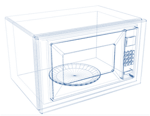

A problem I encounter when microwaving food is that the centre is no penetrated by the microwaves so remains cool and I have to wait for the heat to be conducted through which takes a long time and undermines one of the advantages of microwaving which is the speed of the process. Would it make sense to have a microwave whose emission spectrum could be nudged a hair away from optimal absorption, allowing the microwaves to penetrate just a little deeper into the food? Ideally it could be controlled to match the nature of the food being heated. Obviously it shouldn't be possible to adjust it to the extent that it's just passing through the food.

Does your microwave oven have a built-in rotating platter? That is a big help in getting better uniformity in microwave cooking.
http://microwaveturntableplate.com/wp-content/uploads/2014/01/microwave-oven.png

Mine at home does but that doesn't penetrate a big, deep circular pot of nachos.
The microwaves at work are of the catering type and don't have rotating platters; I'm not sure why. Presumably they have some other way of eliminating hotspots but the same problem applies; hot exterior and cold interior!
For some products, cooking at a 70% to 80% power can assist.
I already do limit power to permit more time for conduction of heat but the thing is, I'm not really interested in finding solutions that fudge existing designs into sort of working. I already know about these and wouldn't have come to a physics forum to ask! I want to know whether it's not feasible for a microwave to adjust the frequency ever so slightly that the microwaves penetrate deeper into the food (but not so much that they just pass right through, obviously). I don't know how the frequency of the waves generated is controlled and whether it's practical to vary them but I guess there aren't many people around who would really know the answer to how a microwave functions in such detail.

Of course there are plenty of folks here who understand how microwave generators are used in commercial microwave ovens. That's not really the issue here. And BTW making them chirp a bit in frequency would hopefully be fairly inexpensive, but would definitely add cost to the microwave generator.
The harder question is whether some modulation of the wavelength of the microwave cooking radiation would improve the uniformity of the heating, allowing you to increase the power and decrease the cooking time, right? That's less of a physics/EE question, and more of a specialized material science question, it would seem...

That's actually not the case. The frequency used is nowhere near any resonance in water. (In addition, there would be no unique resonance frequency for all water molecules in different food stuffs.) The transfer of energy takes place through dielectric heating. You can have a look at Wikipedia for more details: https://en.wikipedia.org/wiki/Microwave_oven

The frequencies are regulated to prevent interference with radio services, but basically any frequency in the microwave region would be suitable for cooking - it does not depend on water resonances.

yeah I was taught that bad science as well ... it isn't true
water molecule resonance is in the Terahertz, not in the low Gigahertz
seanspotatobusiness said:
Thus, I don't suppose there's anything to be done about improving penetration by tweaking the frequency.
no, as you cannot "tweak" the freq anywhere near enough to make any significant difference
