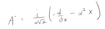

Show that application of the lowering Operator A- to the n=3 harmonic oscillator wavefunction leads to the result predicted by Equation (5.6.22).
Equation (5.6.22): A-Ψn = -iΨn-1√n
I began by saying what the answer should end up becoming. I said that in the end I should get -iΨ2√3 and that Ψ2 was equal to the equation I have above. Then I took the equation for Ψ3 and applied the lowering operator to it in an attempt to get what the prediction is. However, once I applied the lowering operator, I end up getting stuck after taking the derivatives and I get something that looks absolutely nothing like the prediction. I'm confident I took the derivatives correct though since they were never really complicated to begin with. I'm just wondering if maybe my setup is incorrect?
Your expression for the lowering operator ##A^-## is not quite right. If you check the dimensions of ##\frac{d}{dx}## and ##\alpha^2 x## you will find that these two expressions don't have the same dimensions if ##\alpha## is defined as ##\frac{m \omega}{\hbar}##. There is a simple fix for this. If that's not the source of your difficulty, then it would help to see the details of your work.
I'll be honest I found these equations from online. None of them were given to me in the problem, it just expects me to either know the equations or look them up. I guess it's possible I'm using the wrong lowering operator. Is it possible that the α in the denominator should be in a square root and the α next to the "x" should not be raised to the 2nd power?
Yes, that's right.
Ok great! In that case I'll try again thursday when I have time. Thank you!
