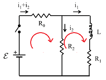

LR circuit in parallel, need someone to check answer
In summary, the switch is closed at t=0, and the inductor is not in the circuit. I1 and I2 are found by solving an LR circuit for t=0 and t=∞.
Erik P
33
L is a perfect inductor with inductance L. The switch is turned on at t=0 and the currents i1 and i2 run trhough the circuit as indicated by the figure.
Given this circuit I need to find i1 and i2 for t=0 and t => infinity.
For i1 i figure it is simply an LR circuit so we can use the following:
\begin{equation}
I(t) = \frac{V}{R}(1 - e^{-\frac{Rt}{L}})
\end{equation}
Which becomes:
\begin{equation}
i_{1}(t) = \frac{\mathcal{E}}{R_0 + R_1}(1 - e^{-\frac{(R_0 + R_1)t}{L}})
\end{equation}
for t=0 i1 = 0 and for t => infinity i1 => E/(R0 + R1)
i2 is constant and is:
\begin{equation}
i_{2} = \frac{\mathcal{E}}{R_0 + R_2}
\end{equation}
Is this correct?
You've still got R1 and R2 in parallel, and both of these are in series with R0.
In the short term, this circuit is going to act like L = 0, and I don't think that's what you have.
Would you be so kind as to elaborate a bit on that? What kind of implication does this have? I'm a bit lost now.
For the short term, pretend the inductor is not in the circuit and analyze it just with the three resistors present in order to find i1 and i2.

Think about inductor's behavior at t=0 and at t=∞. You can analyze the circuit by removing the inductor for t=0 and replacing it by a wire for t=∞.

If you want the currents as function of time, apply Kirchhoff rules, but take into account that the potential change along an inductor is UL=L dI/dt.
Write up the change of potential in both loops, along the red arrows. In the right loop, it is
-LdI1/dt -R1 I1 + R2 I2 =0.
What is the equation for the left loop?
You can eliminate I2, and you get a differential equation for I1 as function of time.
In case you need the currents at t=0 and t--->infinity only, think about the inductor. When you get induced voltage across it?
What is I1 through the inductor when the switch gets closed? What is the voltage across the inductor after very long time?

The basic problem with your calculations is you are treating the inductor like it was an open circuit, similar to a capacitor, when it is not.
After the current passes thru R0, it is going to split in the parallel branches, with one part going thru R1 and the rest thru R2. You must figure out how the current divides in these two branches, based on R1 and R2.
The presence of the inductor affects only the transient behavior of the current just after the switch is closed. Once these transients settle down, the inductor no longer has any effect, at least for a circuit having DC current.

I found the solution for the long term, the transient part I'm a little in doubt as to.
For the long term here is the solution:
\begin{equation}
V_1 = i_1R_1
\end{equation}
\begin{equation}
V_2 = i_2R_2
\end{equation}
\begin{equation}
V_1 = V_2 \Rightarrow i_1R_1 = i_2R_2 \Rightarrow i_2 = \frac{i_1R_1}{R_2}
\end{equation}
\begin{equation}
V_0 = (i_1 + i_2)R_0 = (i_1 + \frac{i_1R_1}{R_2})R_0
\end{equation}
\begin{equation}
V_0 + V_1 = (i_1 + \frac{i_1R_1}{R_2})R_0 + i_1R_1 = \mathcal{E}
\end{equation}
\begin{equation}
\mathcal{E} = i_1R_0 + i_1\frac{R_1R_0}{R_2} + i_1R_1
\end{equation}
\begin{equation}
i_1 = \mathcal{E}\frac{R_2}{R_1R_2 + R_0R_1 + R_0R_2}
\end{equation}
likewise for i2:
\begin{equation}
i_2 = \mathcal{E}\frac{R_1}{R_1R_2 + R_0R_1 + R_0R_2}
\end{equation}
For t=0 the inductor stops current flow so i1 = 0, and i_2 becomes E/(R0 + R2) as i posted in one of the previous replies. Is this reasoning correct?

It is correct.

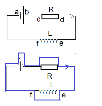

Remember the voltage across an inductor is UL=L dI/dT. It is still true that the voltages along a closed loop add up to zero.
You might look at my Post #16.
Erik P said:
and I'm also supposed to find E~ and R~, however I can't seem to find any information on the ~ over E and R, what does it mean? Is there a specific law I should be looking at, etc.
That's where Thevenin's Theorem comes in. You should have covered Thevenin and Norton equivalent circuits in circuit analysis prior to the introduction of inductor and capacitor components.
You want to remove the inductor from the circuit and replace the remaining voltage source and resistor network with a Thevenin equivalent circuit. It will consist of a voltage source and a single resistor. Those are your "E~" and "R~". Then when the inductor is re-inserted you have a simple series RL circuit to analyze.

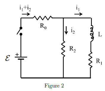

Do you want me to post it as a separate reply or as a part of the original post? Also the R0=R1=R2=R is an edit, looking at post #21 you can see it was originally written as part of the problem.
In any case here is the full description as a reply:
"We consider the circuit shown in Figure 2, where E is an emf source, R0, R1, and R2 are resistances and L is an ideal coil. The switch is turned on at the time t=0 and the currents i1 and i2 run through the circuit as indicated by the figure.
a.) Determine i1 and i2 right after the switch is turned on at the time t=0 as well as for t => infinity.
ANSWERED
b.) Show by using Kirschhoff's law at the time t>=0 that
\begin{equation}
\frac{di_1}{dt} + \frac{\tilde{R}}{L}i_1 = \frac{\tilde{\mathcal{E}}}{L}
\end{equation}
and determine R~ and E~.
Found R~ and E~ by using Thevenin's theorem.
\begin{equation}
\tilde{\mathcal{E}} = \mathcal{E}\frac{R_2}{R_0 + R_2}
\end{equation}
\begin{equation}
\tilde{R} = \frac{R_0R_1 + R_2R_0 + R_1R_2}{R_0 + R_2}
\end{equation}
Not quite shown the equation yet.We now assume that R0=R1=R2=R.
c.) Determine i1(t) and i2(t) for t >= 0 and plot them as functions of t.
This should just be inserting R into the place of R0, R1, and R2 in part a.
Short term:
\begin{equation}
i_1(t) = \frac{\mathcal{E}}{3R}(1-e^{-\frac{2R}{3L}t})
\end{equation}
\begin{equation}
i_2(t) = \frac{\mathcal{E}}{3R}(1-\frac{1}{2}e^{-\frac{2R}{3L}t})
\end{equation}
Long term:
\begin{equation}
i_1 = \frac{\mathcal{E}}{3R}
\end{equation}
\begin{equation}
i_2 = \frac{\mathcal{E}}{3R}
\end{equation}
Kirchhoff laws do not hold good in a circuit with time varying magnetic flux through it !(mag field changes through the inductor)
here is a link to a lecture by Walter lewin where he says that ,and says why.(skip to 33:48 for it, if you want to) link:
he says Kirchhoff's law is a special case of Faraday's law where d(ΦB)/dt = 0
also there is a closed discussion on PF on the same matter link is: https://www.physicsforums.com/threads/is-mit-prof-lewin-wrong-about-kirchhoffs-law.453575/
Kircchoff's laws will arrive at the same result despite the observations and details noted by Prof. Lewin. Circuit analysts tend to stick with the Kirchhoff approach.
\begin{equation}
\end{equation}
\begin{equation}
\end{equation}
\begin{equation}
\end{equation}
Correct.
Short term:
\begin{equation}
\end{equation}
\begin{equation}
\end{equation}
Long term:
\begin{equation}
\end{equation}
\begin{equation}
\end{equation}
Check the exponents and the sign in i2(t).
2nafish117 said:

Levin says that the solenoid produces an emf in the closed loop, so the potential drop across it is zero and you can not apply Kirchhoff's rule. Kirchhoff's voltage rule, as we learned it long ago, said that the sum of voltages along a closed loop was equal the sum of the electromotive forces. And emf involved some non-electric concept . In case of a battery, it included some chemical process. In case of a solenoid, it included magnetism.
Remember, quasi-static electric field is conservative. That means, the work done on unit charge between points A and B is independent from the path taken.
You can go around the circuit along a path in the air as the blue line in the figure, while Levin goes round along the physical wires, and says that ΣUi=Σεj. But the emf of the battery is negative of the potential drop across it. The induced emf of the coil is negative of the potential drop across it. You can imagine that the surface you integrate B is completed by the blue path outside the solenoid so the potential drop from e to f in the air plus the zero potential drop inside the solenoid is equal to the induced emf. If you trace the voltage across terminal of the solenoid with a cathode ray tube as voltmeter, you see the voltage is the same as negative of the induced emf. So you can write Kirchhoff's voltage law as ΣUi=0. The sum of all potential drops along a closed loop is zero. It s easier to understand, and it does not include non*electric terms.
In case of a battery, we don't bother how the electric potential changes inside it, and the current flows from the negative terminal to the positive one through the battery, so Kirchhoff's rule does not apply. We say, that one electrode is positive and one is negative and when we go round the loop, we consider the emf of the battery a negative potential drop.
The same with the coil. We forget the magnetic field, we say that there is a potential drop of LdI/dt across the coil.

If you are referring to equation (1) in post #21, you may have missed that ##\ \tilde{\mathcal{E}}\ ## and ##\ \tilde{R}\ ## are the Thevenin equivalent emf and resistance. The current in a circuit with voltage source, ##\ \tilde{\mathcal{E}}\ ## in series with resistance ##\ \tilde{R}\ ## and inductance ##\ L\ ##, is identical to current ##\ i_1\ ##.
  • #31
what is Thevenin equivalent emf?
  • #32
Back in post #18 , gneill posted the following.
Here is a link to the Wikipedia entry for Thevenin's[/PLAIN] Theorem .
