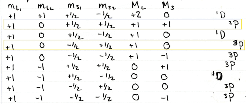

In summary: The answer is that the 3P term includes the 1D state, and the 1D state includes the 3P state. This is why we choose to disallow the 1P state rather than the 3P state.

My question is this - how does this lead to the conclusion that the allowed terms are 1S, 1D and 3P ? For example, there's a ML = 0, MS= -1 term in both 3S and 3P - why do we disallow one and not the other?
Also, what leads us to disallow 1P (for which ML=-1, 0, 1 and MS=0)? Surely the only way to have MS = 0 is to have [tex]\downarrow_1 \hspace{0.1 in} \uparrow_2[/tex] or vice versa, and hence [tex]m_{s1} \neq m_{s2}[/tex] and we have no violation of the Pauli Exclusion Principle?

Ok let me try and clarify what I'm confused by. Have a look at the following table which I have taken from my notes:
In this table we are looking at part of the identical (np)2 configuration. There are 15 possible configurations, all of which I haven't posted.
Take a look at the 2nd row. I can see why this state corresponds to the 3P term. For it to be a P term, it must have L = 1 where [tex] L \geq |M_L|[/tex]. It clearly has this. For it to be a 3P term, the multiplicity 2S+1=3 i.e. S=1 where [tex]S \geq | M_S |[/tex]. This is obvious.
Now if you look at the 4th row, I am not sure why it also has to be a 3P state . I understand that it can be (i.e. that the 3P term includes this state), but this could equally well be a 1P state, no? This is because here S=0. Therefore why do we choose one and not the other?
