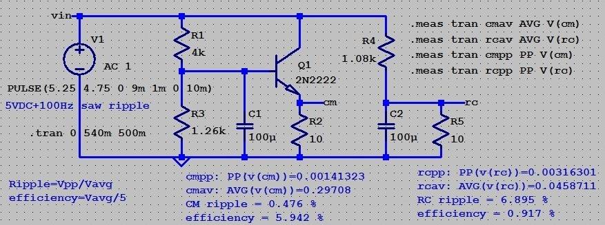

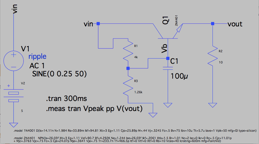

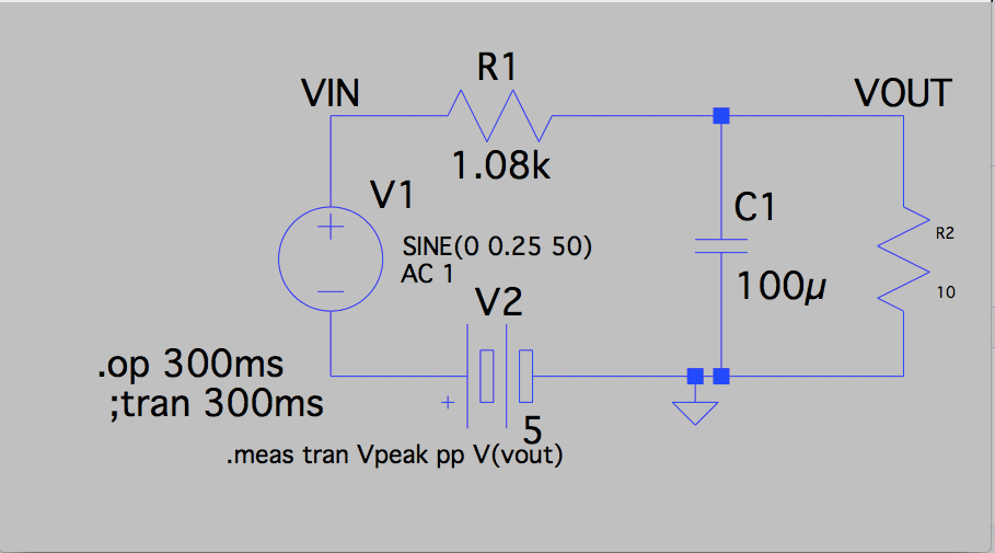

Hi friends,
I have simulated two circuits, one is an RC filter and other is a Capacitance multiplier.
My aim of experiment is to validate a decrease in Iout (load current) of CM circuit as compared to load current in RC filter circuit.
Theoretically,
Iout (CM circuit) < Iout (RC filter)
Vp-p (CM circuit) < Vp-p (RC filter)
My results:
1.RC filter
Vout (dc) = 0.0458716 ( .op 300ms)
Iout (dc) = 0.00458716
Vout (ac) = 43.7 ~ 48 mV (.tran 300ms)
Iout (ac) = 4.80 ~ 4.37 mA
Vp-p (ripple) = 0.00437018 (.meas)
2.CM circuit
Vout (dc) = 0.323751
Iout (dc) = 0.0323751
Vout (ac) = 322 ~ 327 mV
Iout (ac) = 32.65 ~ 32.15 ma
Vp-p (ripple) = 0.00521016 (.meas)
From the above results its quite clear that implementing CM circuit causes Iout to increase which particularly against the aim of the CM circuit. As the CM circuit works by decreasing the load current which according to load POV can be visualised as increase in capacitance.
We can also see the peak to peak ripple voltage in both the circuits, Vp-p for CM circuit should be less than Vp-p ripple of an RC filter, but again the simulations results are quite opposite.
What's wrong here??
Is this not just an extension of your previous thread ?
https://www.physicsforums.com/threads/measuring-ripple-reduction-in-ltspice.1001493/
Why make it so complex ? You have too many places in the circuit to hide difficulties and differences. If the two circuits were merged into one_file.asc, you could compare the results directly.
1. Why specify two voltage sources in series when the DC offset can be specified in one ?
2. What is so special about the detailed 2N4401 model ? Why can you not use a traditional 2N2222 that is included in every version of LTspice ?
3. When 50 Hz is “full wave” rectified, the ripple approximates a saw-tooth with a fundamental frequency of 100 Hz. By specifying a 50 Hz sinewave, you are analysing a frequency component that does not exist, while ignoring every significant harmonic.
Because the CM circuit is buffered with the emitter follower, it has a higher output voltage and therefore a higher output current when operating into the same load resistance. The ripple in the CM circuit is also less because load current is not being drawn from the capacitor.

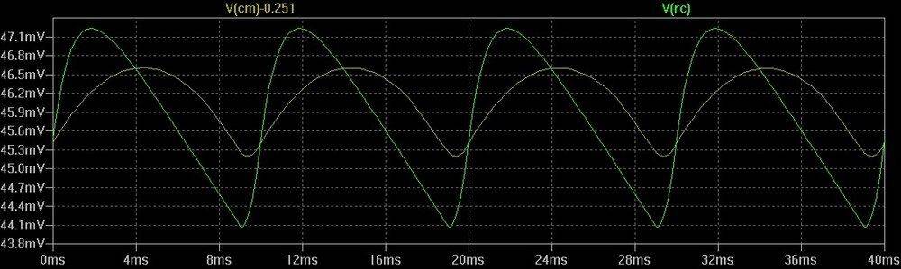

I have given the input waveform a 100 Hz saw-tooth.
Also, offset the DC of the CM voltage in the plot to get better resolution.
