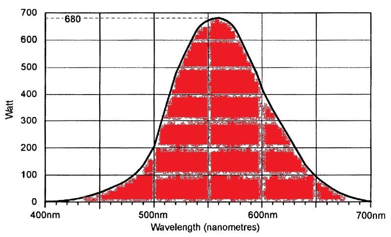

Hello,
I have a small confusion regarding the formula that calculates the luminous flux of a light source, which is given by:
(See this Wiki)
The ##\bar y (λ)## is the so-called luminosity function that corrects for the sensitivity of the human eye for a particular chosen wavelength.
The ##Φ_{e,\lambda}## is the "objective" radiant flux (in watts) per nanometer which is the total power per nanometer, regardless of the sensitivity of the human eye (hence "objective"). You can see from the formula that if a light source emits more than 1 wavelength, an integration has to be done with the limits being the endpoints of the emitting wavelength range, so that it gives the total luminous flux of that light source.
Now, I understand that this formula gives the luminous flux ##Φ_V## in lumen because of the multiplication with ##683.002 lm/W##. However, if we remove this constant, then this means that:
Will give a luminous flux in Watts, right? This means that you can calculate the subjective power according to the human eye's sensitivity in Watts. According to the definition of 1 candela, if we now plug in a wavelength of 555nm of 1 Watt in the formula, we'd get 1/683 Watts out of this formula. This means that the subjective power of 1 candle according to the human eye is 1/683 Watts.
If that's the case, then I don't get why this Wiki says the following:
"The candela is the luminous intensity, in a given direction, of a source that emits monochromatic radiation of frequency 540×1012 hertz and that has a radiant intensity in that direction of  1⁄683 watt per steradian"
Notice that it says that 1 candela is the radiant intensity of 1/683 watt, which is the overall objective power (per steradian in this case) and not the luminous intensity (per steradian) as I concluded, which is the subjective power according to the human eye.
What am I concluding wrong here?
Ok, so I’ve figured out what my misunderstanding was. The Luminous Flux (the formula above) merely shows how strong a light source is relative to a candle that emits light of 555nm at 1/683 Watts, all based on the human eye’s sensitivity.
I have one other question. I understand that if a light source emits several wavelengths, that you’d have to integrate the formula above over dλ as discussed. For each dλ you’d have to give the specified amount of Watts that the light source is emitting for that specified dλ.
What I don’t understand is that this is given by a constant ##Φ_{e,λ}## that gives the amount of Watts per nanometer in the luminosity function. This constant says that the larger the wavelength, the larger the amount of Watts it emits and that it's proportional. But a light source doesn’t necessarily emit larger wavelengths at larger Watts and it surely doesn't emit wavelengths that is proportional to the amount of Watts. So why is this constant in the luminosity function?

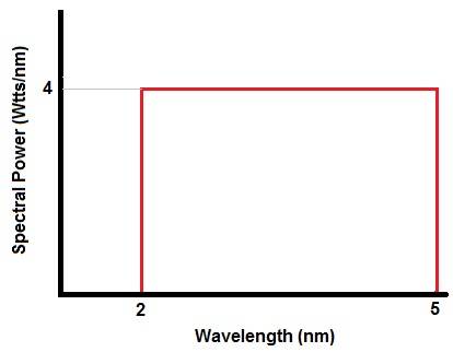

Apologies for my stubborness but I've found a simpler way to explain what I don't understand.
Suppose a light source is emitting light only between 2 and 5 nm, and the spectral power (Wtts/nm) being constant at 4 Wtts/nm over that range of wavelengths (I know it's not supposed to be constant, but just for the sake of argument). The spectral power graph would then look like this:
The luminosity function would integrate this graph. Integration will give an area of 12 Watts.
However, this graph does not represent the absolute power in Watts that each wavelength is emitted at. Spectral power is more like the power concentration of each emitted wavelength. And from what I understand, to know the amount of lumen a wavelength has, one has to look at its absolute power that it is emitted at.
The spectral power (power concentration) of 4 Wtts/nm multiplied by the corresponding wavelength will give the absolute power (##P##) for that wavelength. Multiplying that absolute power (in Watts) of each wavelength with the sensitivity function (Lumens/Wtts) will give the total amount of lumens for that specific wavelength. I'd have to do this for each wavelength and add them all together to get the total amounts of lumens over the whole spectrumrange (2nm -5nm)
So the formula would look something like this:
##P(λ=2) \cdot \overline{y}(λ=2) + P(λ=3) \cdot \overline{y}(λ=3) + P(λ=4) \cdot \overline{y}(λ=4) + P(λ=5) \cdot \overline{y}(λ=5)##
This formula however will give way more total amounts of Watts than the 12 Watts calculated in the spectral power graph.
So my confusion lies in the fact that the luminosity formula uses the spectral power of a wavelength x the corresponding sensitivity function to get the amount of lumens at that wavelength while I think that it should take the absolute power of that wavelength and multiply it with the wavelength to get the amount of lumens at that wavelength. This is what I can't seem to grasp.
You have it correct, but remember that when you multiply by V(λ) the units of the product are no longer Watts. V(λ) has units of lumens/Watt so the number that you get (larger than 12 Watts) is the number of lumens. You should be using the absolute power at a wavelength x V(λ) at that wavelength.
Lumens are a perceptual unit and that makes things peculiar at times. 100 lumens should appear as the same "brightness" regardless of the spectral power distribution.

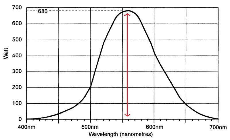

Ok, let's take this step by step to see if I understand this. Suppose a light source is emitting just one exact wavelength, which is 500 nm, at 2 Watts. The sensitivity ##\overline{y}(λ)## of the human eye for any wavelength at a particular amount of Watts is measured with respect to a wavelength of 555nm at 1/683 Watts. When looking at the graph for eye sensitivity, I can read that the ##\overline{y}(500nm) = 0.3##.
This means that the eye sensitivity of a wavelength of 500nm is 30 percent of the sensitivity of 555nm if both wavelengths are emitted with the same amount of Watts. The more Watts a wavelength is emitted at, the more the eye is sensitive to it.
This means that a wavelength of 500nm at 2 Watts would be ##0.3 \cdot \frac{200}{\frac{1}{683}} = 409.8## times more sensitive than a wavelength of 555nm at 1/683 Watts, thus 409.8 Lumens.
This is done without using the luminosity function. Let's now see how it's calculated using the luminosity function, which says that:
$$Φ_{v} = 683 Lmn / W \cdot \overline{y}(λ) \cdot Φ_{eλ} \cdot \lambda$$
The units of ##Φ_{eλ}## is Watts/nm, so that means that ##Φ_{eλ}## for a wavelength of 500nm at 2 Watts is ##Φ_{eλ}= \frac{2 Watts}{500nm} = 0.004W/nm##. Filling the data in the formula, ##\overline{y}(500nm) = 0.3##, ##\lambda = 500nm## and ##Φ_{eλ}= 0.004W/nm##, indeed gives the same amount of Lumens as before: 409.8 Lumens.
Before I start with my struggle, is what I typed correct so far?

Ok, stop there. Do you mean the source emits 2W at 500.0000000... ±0 nm? That's fine- but then what is your spectral power output? (hint- it's a delta function).
Where did that factor of 200 come from? Regardless, when I did the calculation, I also got that a 2W source at 500nm is 409.8 times as intense as a 1/683 W source at 555 nm.
Here's two errors- $$Φ_{v} = 683 Lmn / W \cdot ∫\overline{y}(λ) \cdot Φ_{eλ} \cdot d\lambda$$ and ##Φ_{eλ}= (2 W) δ(500 nm - λ)##
Evaluating the integral gives 409.8 lm as before.
Does this help?
