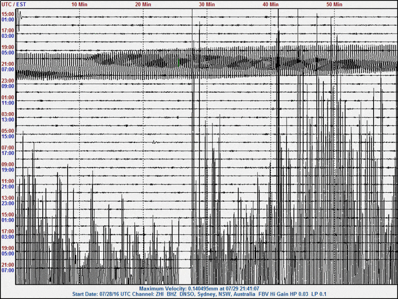

OK here's the raw seismogram

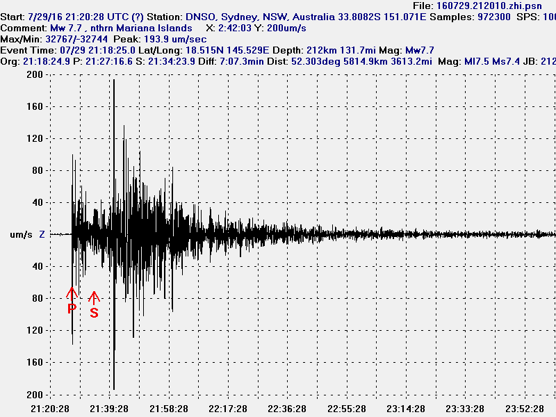

and a processed seismogram with data
Thanks for sharing @davenn . Is there a layman explanation of how the data reduction from raw to processed works?
Likes davenn and 1oldman2
you are welcome ... one of my loves in life :smile:
ohhh ... where do I start ?
firstly, I didn't write the software or design the hardware for my system. Credit for that goes to Larry Cochrane from California
who was one of the original members of the PSN ( Public Seismic Network) in the USA.
http://psn.quake.net/
He designed 2 significant pieces of hardware a multi-channel preamp that goes between the sensors and the ADC data logger.
And the datalogger with its assoc software WinSDR (Windows Seismic Data Recorder)
preamp ... http://psn.quake.net/serialamp.html
ADC/Datalogger ... http://psn.quake.net/serialatod.html
WinSDR ... http://psn.quake.net/software.html#WinSDR
The raw seismogram you see in post #8 is a screenshot of the display on the WinSDR datalogging PC
currently I am using a Dell ( about 3 years old) and running Win7. This PC runs 24/7.
The analysis software that is on my main PC, for loading in and producing the final data file as seen in post #10
is called WinQuake ... http://psn.quake.net/software.html#WinQuake
WinQuake, along with the hardware and WinSDR have gone through many upgrades since its initial release in the early
- mid 1990's ( My station went digital in 1996)
have a read through some of the documentation in the links
hopefully it will answer most of your questions :smile:Regards
Dave
