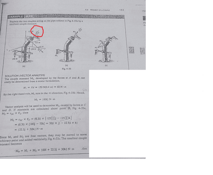

for M2 , if i take the moment at pont C , then my ans would be (0.3i) x ((125X(3/5) j +125(4/5) k )= 30j +22.5k
Which is not same with the book which use moment about D . why ? Is the value at the triangle at te upper part incorrect (circle part) ?
