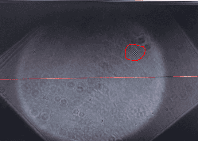

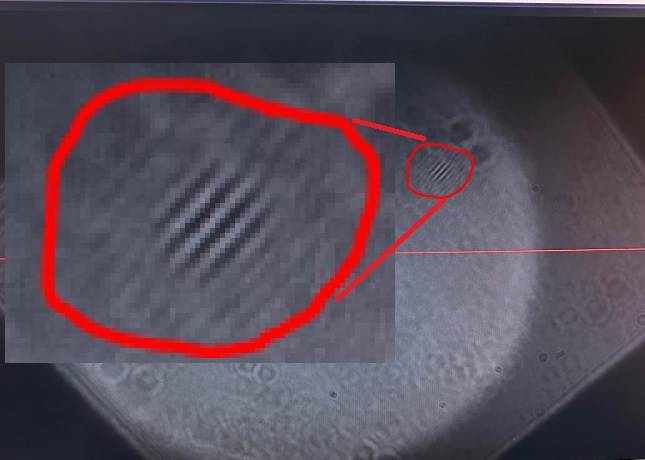

I try to make white light Mach Zehnder Interferometer. I managed to find the interference fringes but the fringe is too small compared to the beam size
I am trying to make the white light Mach Zehnder Interferometer. After going here and there, I got this small interference pattern. Sadly.
Due to the configuration, the beam size of the two arms is not the same ( One arm is equipped with two object lenses, so this arm has a smaller beam size).
Although having different beam sizes, I made two beams with the same intensity by adjusting HWP+ PBS. It is supposed to have an interference pattern in the whole area of small beam size.
I would appreciate it if anyone has a clue to solve this issue.

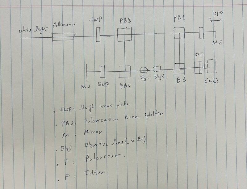

Don't you think you would get better assistance when you provide a little more information ? A diagram and a picture of the setup? You leave us guessing what precisely this 'configuration' is, what the picture represents, what PBS+ HWP has to do with it, etc, etc

This is the setup diagram.
Sadly I do not have the option to use laser.

Thanks. It is quite clear how it works.
Question: What is about interferogram imagine condition? I assume that CCD camera has no lens and micro objectives are with infinity conjugation? Right?
Or, in case if you imaging the interferogram what would be conjugation points?
Looking on you image I would say there is defocus between two arms, where two spherical wavefronts of different curvature coincide by OPD on a local spot, but the phase difference is increasing beyond where you can observe a secondary interference ring with the opposite phase surrounding the main interference spot.

Hmmm.... I think @Gleb1964 makes a good point about defocus.
When troubleshooting, I usually start by removing as many components as possible to try and diagnose the misalignment.
Does the source emit polarized light? Given your source (a halogen bulb), it's not clear what the HWP is doing. Similarly, it's not clear what the QWP is doing in your setup. Does M2 have tip/tilt capability?
I would start by removing both objective lenses and the QWP/ M1 components, then you have a much simpler configuration to work with.

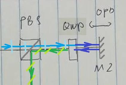

I am not sure about what is doing the HWP (=Half Wave Plate), but after passing the first PBS (=Polarizing Beam Splitter) the light is splitting into two ortogonal linear polarisations going different ways.
The combination of PBS+QWP+Mirror2 is showed on the illustration - linearly polarised light is passing through the beamsplitter, the combination of QWP+Mirror is tilting polarization to ortogonal so on a way back light is reflected by PBS.
The second branch of interferometer is done in a similar way to equalize the path length , but light first reflected by PBS and then transmitted. Both branches are approximately the same optical path length, but one is included tuning of the mirror M2 position to adjust the pass length.

1. We tried to match the imaging condition first before finding the interferogram; we used a resolution test target in the middle of 2 objective lenses and adjusted the CCD and tube lens distance. ( I did not mention tube length in the diagram; my bad !)
2. Your point in defocus is nice! I have the same thinking but have yet to come up with why there is a 2nd interference ring!

If the source is randomly polarized, then rotating the HWP shouldn't do anything; conversely, if rotating the HWP does indeed alter the relative intensities, then the source is not randomly polarized.
Regardless, I stand by my suggestion to remove the objective lenses and see if you can get fringes over the entire active area. That will tell you if your problem is the objective lenses or not. If you remove the objective lenses and still can't get fringes over an appreciable area, then you have misalignment somewhere else.
