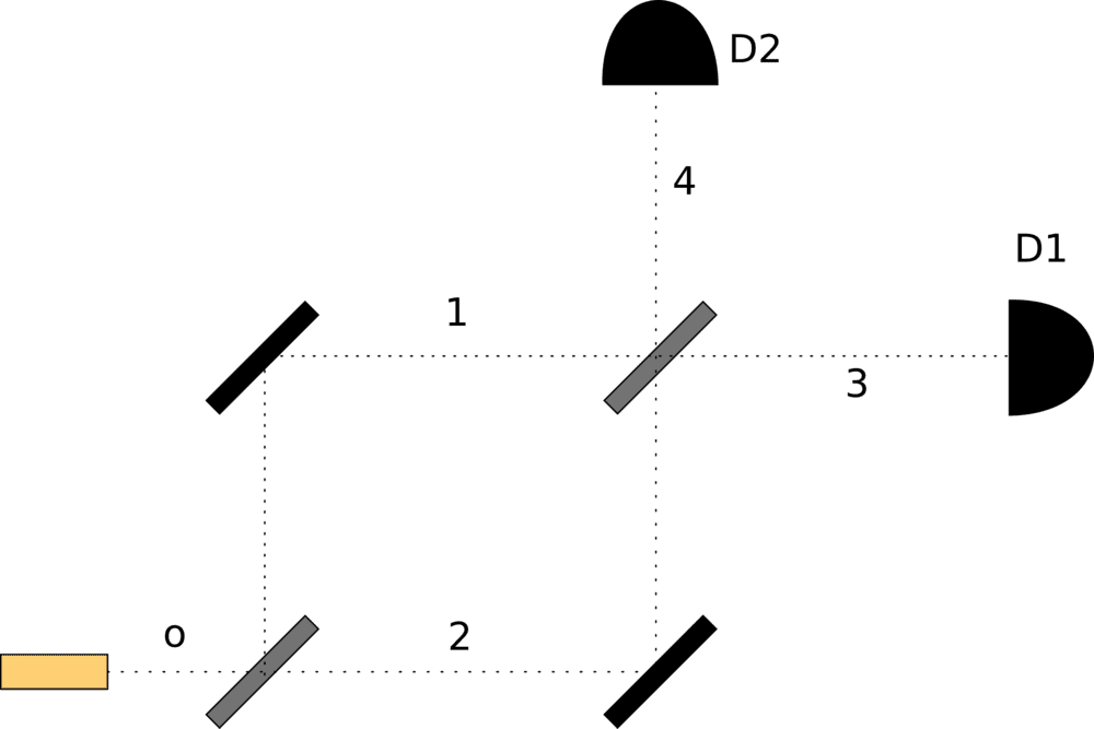

I have a question on how exactly polarizing filters would influence interference in a Mach-Zehnder interferometer.
To explain, I'll show some configurations and what I would expect to happen - please tell me if I am incorrect anywhere.

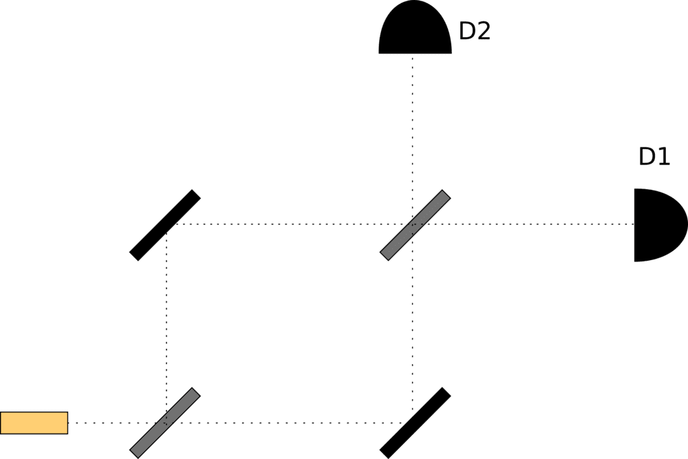

Here is the standard MZI configuration with no filters and a single-photon source on the lower left
In this configuration, 100% of photons will reach D1, none will reach D2, due to the differential phase shifts from the beam splitter. (I assume that both beam splitters are symmetric and shift transmitted and reflected by 90°, as explained here: https://www.physicsforums.com/threa...h-zehnder-interferometer.972867/#post-6188472)

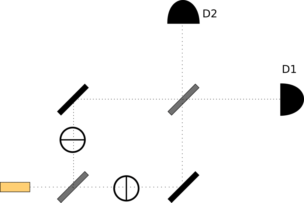

Now I add two polarizing filters, one vertical, one horizontal
In this configuration (with single photons emitted from the light source on the lower left), on average, only every second photon will hit one of the detectors (for simplicity, assume that the light source emits photons with polarization 45°, i.e. a superposition og horizontal and vertical). Of these 50%reach D1, 50% reach D2 because the polarization adds a "which-path information" to the photon state and thus destroys the interference pattern. So overall I have 25% at D1, 25% at D2, 50% lost.

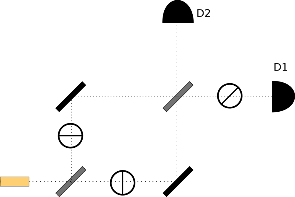

When I now add a third filter at 45° in the D1-path
I expect that this destroys the which-path information. However, the which-path information is still available at D2, so I would expect now that I have 25% of the photons at D2, 12,5% at D1 (number is halved due to the loss at the third filter).

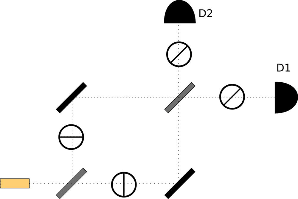

And finally, I add a filter to the D2-path:
Now I've destroyed the which-path information on both paths, so that interference should work again. In this situation I would expect 25% of the photons to end up at D1, none ending up at D2 and the rest being absorbed at one of the filters.
Are all these considerations correct or did I make a mistake somewhere?

I now tried to calculate things explicitly and believe my idea above to be incorrect. (Calculation follows below, I'd be very grateful for someone to check it.)
However, I do see a problem with causality if my idea were correct:
Image we set up the light source to send one photon per second. In scenario 3, Alice at D1 would then expect to find 12.5% of them, so on average one every 8 seconds. When Bob inserts a filter in front of D2, Alice would then find an increased probability of 1/4. With sufficient distance between D1 and D2, I think that this would actually allow to send a message, wouldn't it?
But I think my calculation is incorrect anyway because I did not account for the correct superposition of horizontal and vertical states on the path to D1. I use the following labels for the paths:
The first beam splitter creates
$$|0\rangle \rightarrow \frac{1}{\sqrt{2}} (i|1\rangle + |2\rangle)$$
(as I said, I assume a symmetric BS with 90° phase shift)
The second beam splitter then changes this to
$$\rightarrow \frac{1}{2} (i (i|4\rangle + | 3\rangle) + |4\rangle + i|3\rangle)$$
so the two ##|4\rangle##-terms cancel each other and the full signal ends up in D1.
Adding the polarization state, the final state can be written as
$$\rightarrow \frac{1}{2} (i (i|4 H\rangle + | 3 H\rangle) + |4 V \rangle + i|3 V\rangle)$$
and with this all four terms are orthogonal to each other and I get 50% probability for D1 (25% with H, 25% with V) and the same for D2.
So this seems to be correct (i hope!).
I write the 45-degree polarized state as $$|45\rangle = \frac{1}{\sqrt{2}} (|V\rangle + |H\rangle)$$ or
$$|V\rangle = \frac{1}{\sqrt{2}} (|+45\rangle + |-45\rangle)$$
$$|H\rangle = \frac{1}{\sqrt{2}} (|+45\rangle - |-45\rangle)$$
I can now just write the V- and H- states in the 3-path and get
$$\rightarrow \frac{1}{2} (-|4 H\rangle + |4 V \rangle
+ \frac{i}{\sqrt{2}} (| 3, +45\rangle - | 3, -45\rangle )
+ \frac{i}{\sqrt{2}} (| 3, +45\rangle + | 3, -45\rangle ) )$$
With this, what i now see is that the two states in path 3 actually combine to form a +45°-polarized wave, so no photon should be absorbed at the filter at +45°. Corresponsingly, if I have a +45°-filter on path 4, it will absorb all photons whereas a -45° filter will absorb none.
So the correct probabilities should be that in my situation 3 above, the overall probability at D1 is still 25% since the photons from the two paths actually linearly combine to a +45°-polarization state.
I'm not totally sure if this is the right way to calculate things, though, so if you (or someone else) could check this, I'd be very grateful.

I'm not sure I understand. The beam splitters do not change polarization here, polarization comes into it only in situation 3 and 4 where I explicitly added the filters. That is why i simply added the appropriate H and V to the states in the 3rd equation.
I totally agree that there is no FTL communication, but I think if my first (incorrect) assumption on the probabilities were correct, then there would be (because Alice would be able to distinguish a probability of 1/8 from 1/4). I'm not sure the argument that photons need to be well separated in time would prevent this in principle, nothing would prevent me from building 1000 interferometers next to each other (with very long arms between the second beam splitter and the detector), firing all 1000 light sources at the same time and Bob inserting the filter into all of the light paths. But, as I said, it is totally irrelevant because I am quite sure now that my first understanding was simply wrong.
Ah! I misunderstood you. You are "adding the polarization" for the other cases with the polarizers in the various configurations at place. Then it makes sense.

Sonderval said:
... And finally, I add a filter to the D2-path:
I don't believe the polarizers you added cause anything to be "erased". You'll get 12.5% at both D1 and D2.
