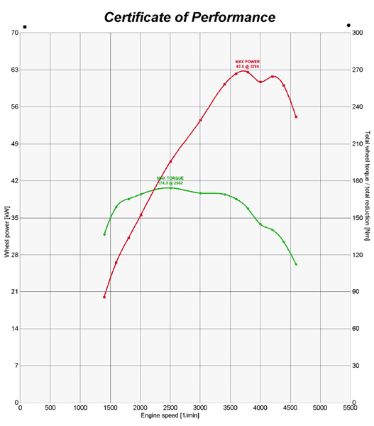

I also have the torque and HP stats of the engine as below:
I need to find the torque of the engine related by the rated torque capacity of the wood chipper = 665.7 Nm. @540 RPM?
Also I need to find out what engine speed can provide the max torque rating for the machine as the engine has to be reduced by a ratio through pulleys to match the max RPM of the machine. My second question is:
2) Does reducing a gear ratio, say 3.7 : 1 multiply the torque by that much? So if;
Torque x gear ratio = torque at the wheel
Then @ 2000 RPM the engine would provide 169.1 Nm , therefore multiply by the 3.7037 times the motor is rotating faster than 540 RPM and you have the figure 625.92 which is under the figure we have for the rated capacity of the wood chipper.

To do this I need to reduce the engine speed by 4 from 2000 rpm to 540 to match the max speed of the the machine?
Also the engine has a power curve of HP so it's not always at 95 hp but that depends on the rpm.
Yes, so that when your engine is at 2000 rpm, the chipper is at 540 rpm, so whatever power your engine is producing at 2,000 rpm this will be reflected at the chipper regardless of the chipper speed, so make sure the chipper is at 540 rpm when youre engine is at 2,000 rpm, so yes the speed reduction ratio between your engine and the chipper is 2,000 : 540, so if it involved two sprockets and a chain, your engine sprocket would have say 25 teeth, and the chipper would have 25 * ( 2,000 / 540 ) = 92.59 teeth (say 93 teeth)
The torque increase from engine to chipper would be proportional to this ratio also.

So if the engine was running at 2000 RPM the power through the engine would be 170 Nm and the HP would be about 40?

So what would your recommendation be for the gear ratio to give as much power as possible?
I am thinking at peak HP @ around 3500 RPM would do it with a reduction of 6.48 to 1?
Thanks for the help
Call a local vendor for a V-belt drive. Your 6.8 to 1 looks good.

The maximum power of your engine is 62.6 kW (84 hp) @ 3789 rpm. To drop it to 540 rpm, you need a 7:1 gear ratio (=3789 / 540). The power at the chipper will be 84 hp (minus some losses in your gear/pulley/chain reducer, probably something like 5% or about 4 hp). So you will always be below the 105 hp, because you cannot increase or reduce the power produced by the engine.
For example, if you put a 3.7:1 gear ratio, you would have to run the engine at 2000 rpm to get the required 540 rpm (3.7 * 540 = 2000). At that rpm your engine produces a maximum power of about 35 kW (47 hp). Subtracting a 5% loss (2.4 hp), you end up with 44.6 hp at the chipper's input.
What it means is that your engine will not be able to perform as much work as it was intended to do, no matter the rpm you choose (and that is assuming you run your engine full throttle, which might not be recommended for a long period of time). Either you will have to feed it slower or you will have to put smaller branches. But if you want more from you chipper (or any machine for that matter), you need more power.
Forget about torque numbers, what is important is power. If the specs would have been 1021 lb.ft @ 540 rpm, you should have said to yourself: «I wonder how much power that is?» You do the math, find 105 hp and then you would have said: «Ah! I need an engine that can produce 105 hp and - no matter at what rpm it produces that 105 hp - I need to bring its speeds down to 540 rpm.»
Normally you would want to use the engine at a rpm where it has the best fuel consumption (which is usually somewhere around maximum torque; it depends on the load your putting on the engine). If you choose an ideal engine, it should be able to produce the 105 hp at that rpm.
So your engine is probably build to perform best at around 2500 rpm (that could include performance of the cooling and lubrication systems as well), where you won't be able to get more than 45 kW (60 hp), and that is full throttle. The engine would usually be used at 84 hp @ 3789 rpm for short period of time only (maybe that is your intended use?). Only racing engines are usually prepped to perform at maximum power "all the time" (where "all the time" could mean one season - or even only one race - before an overhaul is due).

Thanks for all the replies, I have spent considerable time working this out. At the moment I am working with this:
My plan is to have a compound pulley system with 3 groove vbelt pulleys rated to at least +20% over 105 HP.
I am looking at the 2 pulley sizes of 117.5 and 305.5 and being in a drive chain to have 2 of each.
they give a ratio of 2.6 : 1 so 2 of them is 2.6 x 2.6 = 6.76.
so at 3,650 RPM it will be reduced by 6.76 times giving 539.4 rpm. So this gives peak power at peak revs.
Please can you confirm if this is right or REALLY IS ALL IN MY HEAD! :confused:
Your maths is good,
I trust your engine is comfortable at those revs, don't forget the power rating will only be at full revs and diminished further down the rev range.
Your transmission will be : smaller pulley on engine to large pulley/small pulley unit idler, then on to larger pulley on chipper.
