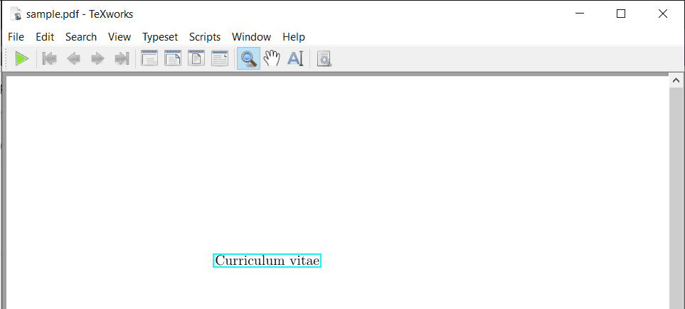

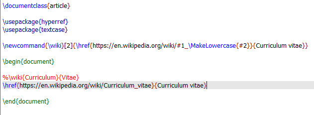

What happens if you write it out directly without using the \wiki command?
DrClaude said:
I got a feeling that the problem stems from the presence of \MakeLowercase inside \href.
I do believe that is the problem, here. When typing out the hyperlink commands manually, I get a pdf document with a working hyperlink and all. Capture1.PNGCapture.PNG
