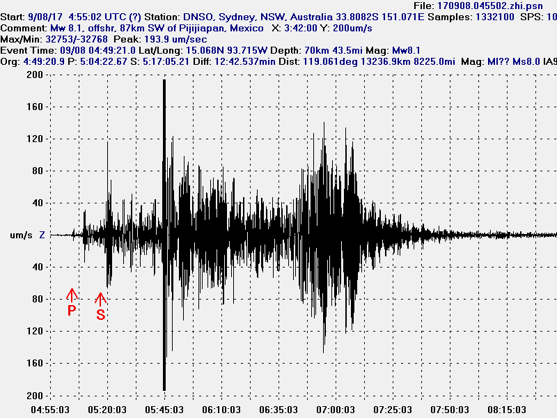

tis still coming in on my seismo ...
http://www.sydneystormcity.com/seismograms.htm

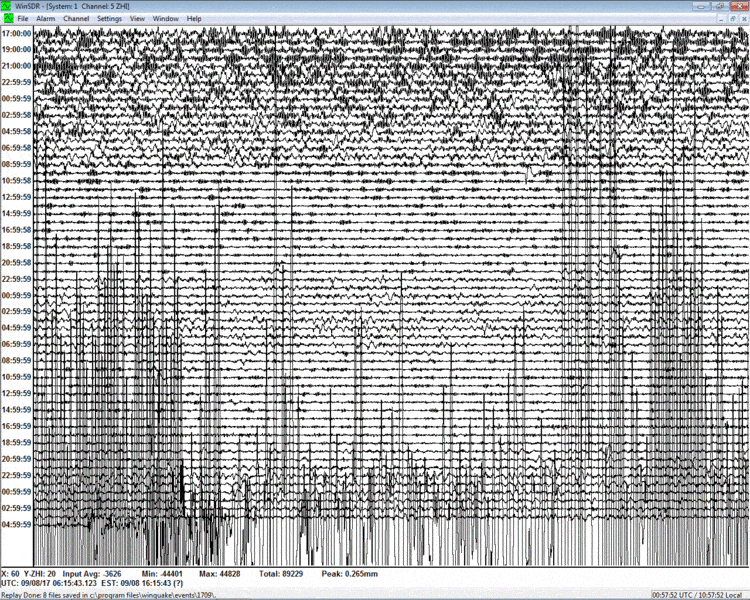

raw and processed seismograms from my recorder
Dave

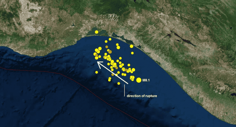

A classic example of a unilateral rupture ( rupture on the fault starts in one place and goes in one direction only)

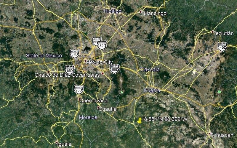

M 7.1 - 5km ENE of Raboso, Mexico
Time: 2017-09-19 18:14:39 (UTC)
Location: 18.584°N 98.399°W
Depth: 51.0 km

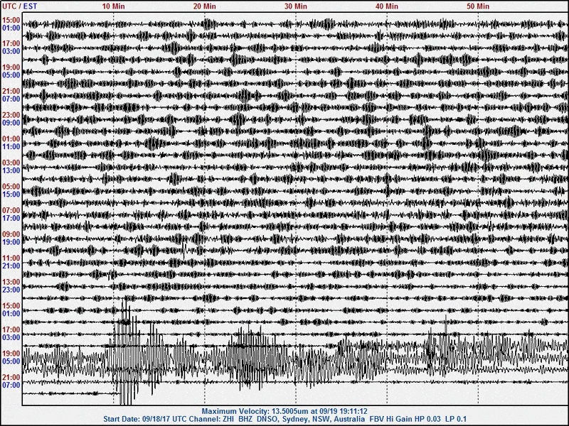

a raw seismogram of the M7.1 from my recorder... I haven't had a chance to process it yet
note the much smaller amplitude compared to the M8.1 up the thread post#14
only 120km SSE of downtown Mexico City
Dave

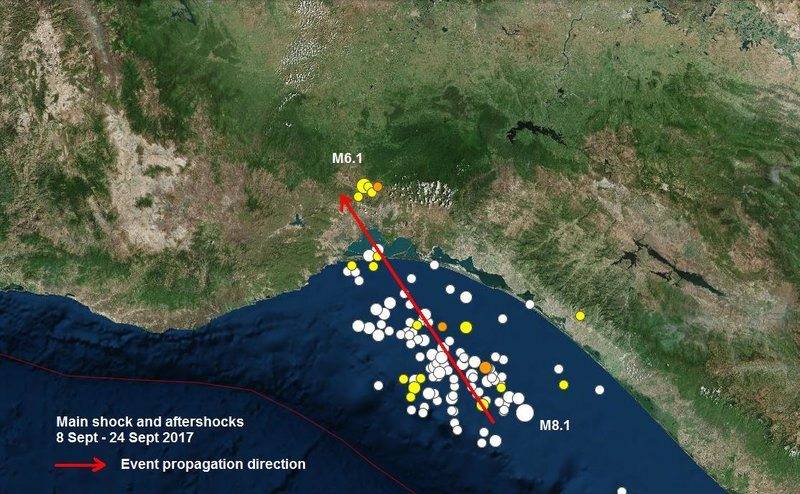

Updated aftershock zone for the M8.1
Events M4.5 and greater for the 8th Sept to 24th Sept
still clearly showing a unilateral rupture in the nor-westerly direction
cheers
Dave
