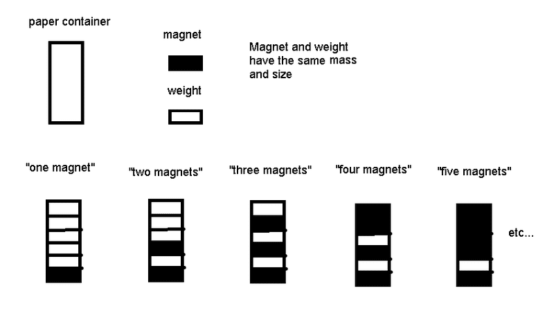

Experiment: what is the effect of the # of magnets on the time of drop through the pipe?
Magnets are placed in a paper cylinder container
- "one magnet" is 1 magnet and 5 weights (mass of 1 magnet and 1 weight is equal)
- "two magnets" is 1 magnet, 1 weight, 1 magnet, 3 weights etc...
See picture

My hypothesis is that an increase in # of magnets will cause an increase in time of drop. However, my explanation for this is a bit hazy as I am having a bit of trouble connecting all the laws. Please help me explain this phenomenon and check if my understanding is correct thus far. Also, will something cool happen at "four magnets" (see pic)? Since 2 magnets will be touching. Will that cause a change in magnetism? Will there be a steep rise on the # vs time graph?

That is a good approach!
Now you need some estimate how often / how significant the magnetic field is changing if your weights+magnets travel down the tube. For multiple magnets, it will depend on the magnet orientation, too.
Any current produced in the copper (called Eddy current) will produce a magnetic field to oppose the magnet motion...will it pull or push?
I think both: push up at the beginning, pull down at the end. Since Faraday says flux (from magnet?) induces a current, and Lenz says that this current opposes the change in flux, therefore it should be trying to get rid of the magnet. Right?
No, it will try to resist the change, which comes from the motion. It will always give a force against the motion.
