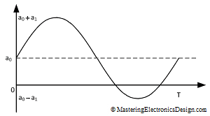

Look at the graph below and imagine it is the flux through the coil. Instead of going a full amplitude plus-to-minus, it is changing less because it is mostly one-sided. If it were the flux due to a full N-S-N changing flux, the amplitude of the change in the flux would be larger and evenly distributed above and below the zero line.
Does that help?
