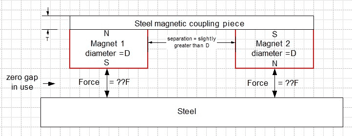

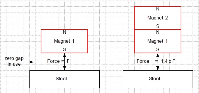

On the left we have a disc magnet diameter D attracted to a much larger lump of steel with force F (when there is no gap between).
If I add a second similar magnet, a website selling magnets I found tells me the force increases to about 70% of the sum of the two - shown on the right.
magnets2
If I arrange the magnets as shown with the spacing a little more that the magnet diameter and a bridging steel pole piece straddling the two as shown. Note the right hand magnet has been flipped N-S
What is the force between each magnet and the lump of steel at the bottom?
Does that force vary much with the thickness of the pole piece T?
Does the pole piece even do anything useful?
Without the pole piece I assume the attraction of the two magnets in isolation would be F each but
Does the pole piece help increase this? if so how much by?
In my mind I have the idea that there is now a "magnetic circuit" via the pole piece and the steel lump at the bottom but is a magnetic circuit even a real thing.
Not looking for pages of maths just a real world idea of what it means

A "magnetic circuit" is a thing, but it probably does not help you. It does not directly help you predict the force.
Unfortunately, predicting the force is difficult, requires a lot of information that we don't have, and in many cases is approximate at best. I would go with what the vendor is saying, but be prepared to have to make measurements.
That's nonsense. Making the magnet taller does not increase its force on a steel piece attracted to one side.

Generally speaking, in a magnetic circuit, the attractive force is roughly proportional to the surface area and the square of the magnetic flux density, and inversely proportional to the gap length.
Maybe you can try to use these principles to make a rough assessment.
I disagree ...with caveats. So long as the nearer permanent magnet is not saturated then the addition of more magnets will increase the field because there is still some susceptability remaining in the lower magnet. The field strength at the lower pole will increase and the attraction is quadratic in that field strength at the pole. Its just like making a solenoidal electromagnet longer. Real magnets (particularly ones with some age on the) are seldom saturated.
Of course closing the magnetic circuit is a much better technique (or close the circuit and add magnets! )
Interesting point; I hadn't considered that angle. I was mainly bothered by the longer magnetic path...

The steel "magnetic coupling" piece will have an induced magnetization - with a "north pole" on the right, and a "south pole" on the left. This will increase the strength of the magnetic field applied to the large steel block at the bottom, creating effectively a single large "north pole" on the right (at the bottom of the magnet) and "south pole" on the left. Assuming the magnetization of the steel block is not saturated, it will be more strongly magnetized than without the "coupling piece" on top. Hence the attractive force will be (somewhat) stronger.
