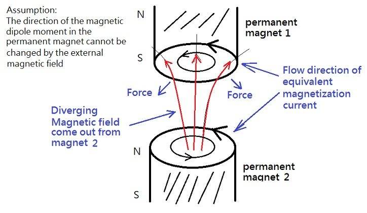

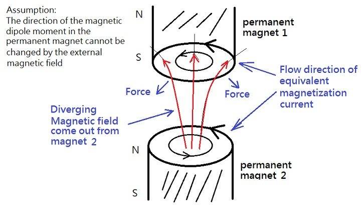

I'm trying to understand how the Lorentz force can explain why magnets attract and repel
I used to have the same idea as you, that is, how to use Lorentz force to explain the attraction and repulsion between magnets. I also tried to find relevant information on the Internet, but could not find it. Therefore, I used an intuitive drawing method to solve this problem, as shown in the figure below.
Just as when we calculate the attractive force between the two plates of a parallel plate capacitor, we only consider the electric field generated by the charge on one plate, and then calculate the force that this electric field exerts on the charge on the other plate. Therefore, the point here is that in order to correctly apply the Lorentz force, we should consider the magnetic field generated by one of the two magnets, and then infer the force of this magnetic field acting on the equivalent magnetization current of the other magnet.
Using the same method, when we consider the magnetic field generated by magnet 1, we will also draw the conclusion of attraction, and when the polarity of one of the two magnets is reversed, we will also draw the conclusion of repulsion.
Likes SamRoss, Charles Link, vanhees71 and 1 other person

I want to comment on @alan123hk 's post 22. Very good, but one comment is for uniform magnetization, the equivalent currents are not on the endfaces, but rather along the outside cylindrical surface, as if the magnet were a solenoid. Otherwise, a very good explanation and diagram.
Likes alan123hk, SamRoss and Delta2
alan123hk said:
...and then infer the force of this magnetic field acting on the equivalent magnetization current of the other magnet.
Thanks, @alan123hk ! This seems to be EXACTLY what I was looking for!
A couple of quick questions to make sure I'm interpreting everything correctly...
1. The black arrows representing the equivalent magnetization current would be the v in the F = qv x B formula (and, of course, the red arrows would be the B and the blue arrows would be the F). Is that correct?
2. There is not really any current in the magnet (at least, none that contributes significantly to the magnetic field). The current depicted in the diagram is the result of the spins of the electrons in the magnet cancelling out on the inside, resulting, as @Charles Link said, in a current which is only on the outside of the magnet as in a solenoid.
Of course, the electrons are not literally spinning either but each of them produces a magnetic field as if they were. Is all of this correct?
Likes alan123hk
Yes. It might interest you that the equivalent magnetic surface current per unit length ## K_m=\vec{M} \times \hat{n} ## in units where ## B=\mu_o(H+M)##. See also https://www.physicsforums.com/threads/a-magnetostatics-problem-of-interest-2.971045/
and also see https://www.physicsforums.com/insights/permanent-magnets-ferromagnetism-magnetic-surface-currents/
Thank you for pointing out the problem with the diagram.
I plan to fix this when I have the opportunity to upload it to the internet next time :rolleyes:
