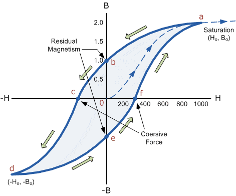

Fededevi said:
(I do not understand this, why is reluctance decreasing when the path is saturated? )
Typical magnetizing curve:
When the B-field closes up yo about 2 Tesla, the steepnes of the curve, which is μ, decreases.
μ = dB/dH
