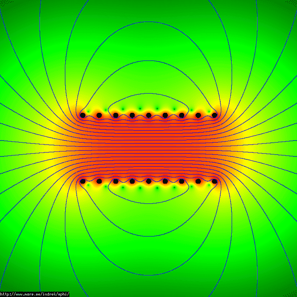

As seen in the figure, magnetic field is not "focused" to the center of the coil that I suggest therefore plasma cannot be confined merely with torodial field coils but position control coils must also operate in order to keep plasma away from the walls (or wires in the picture).

This has nothing to do with the shape or field geometry of a tokamak.
mfb, I think you don't understand. I am asking you why plasma does not touch the walls where magnetic field is as strong as the inside. Why is plasma confined only in the middle?
The tokamak requires that the magnetic field lines be twisted along the toroidal axis, otherwise the plasma will simply leak out. This can be done by inducing a polodial plasma current, or by using another set of external magnets.
By twisted along, do you mean it should be in a torus shape or do you mean a polodial field must also be applied, creating a helix? I though the polodial field or current was needed to prevent charge accumulation and sustain the confinement. What I am saying is not relevant to that. I will ask it in a simpler way: There is a selenoid and plasma confined inside it. Two ends are plugged with mirror coils. Can the plasma escape from the selenoid, not the two ends? Where magnetic field is there might be plasma, so why does the plasma not reach the coil itself, or the walls?

I believe the prevention of charge separation is part of it, but in a homogeneous magnetic field (like in your solenoid above) particles will drift in a direction that is perpendicular to both the magnetic field lines and another applied force (such as gravity or an electric field).
I believe so. To my knowledge the particles can drift out of the center and collide with the solenoid walls.

OK, I read more about the drift but I still cannot understand why magnetic confinement is even possible.
Imagine a magnetic mirror and plasma confined within. How does plasma not touch the coils? There is magnetic field around the wires as well as the inner part.
