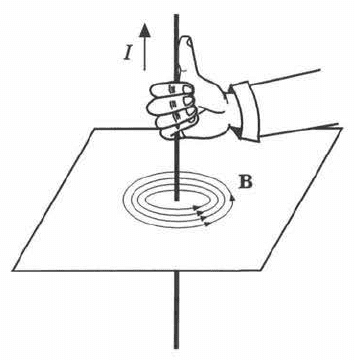

Question!
Will a magnetic field be created around a conductor with a current of protons?
By analogy with the magnetic field of electrons in a conductor.
Yes, definitely. In stars you get large magnetic fields due to currents of both protons and electrons. You can also get currents due to flows of both anions and cations in an electrolyte. That is in fact what makes them electrolytes. The charge and the charge to mass ratio of the charge carriers doesn't matter, a given current will produce the same magnetic field regardless of the nature of the charge carriers.

Thank you for your reply.
Tell the created fields will be different? Maybe they will be sent to the anti-cold side? Arrows north, south pole in different directions? For example, the electron current creates a field with a clockwise rotation, and a proton field in the opposite direction?
Ibix said:
Yes.
Maxwell's equations depend on J (current density), not on the nature of the charge carriers used to obtain J. So if you fix J then the nature of the charge carriers does not matter, the resulting fields will be the same.
Of course, a given J will require protons to move in the opposite direction as electrons would move. Specifically, protons move parallel to their J and electrons move antiparallel to their J.

Are you talking about the magnetic field around the conductor? And say it will be the same? Maybe when moving along a proton conductor, the field will be directed to the other side? Maybe you will need to change your hand from right to left? This will be the difference fields?
What do you mean when you talk in parallel and antiparallel?
Again, there will be no difference in fields. No difference. None. Zip, zero, zilch, nada, none, null, etc.
parallel:
Antiparallel
Likes Ksheva
@Ksheva - to be clear, a current flowing upwards will produce the same field whether the moving charges are protons or electrons or whatever. But "current flowing upwards" describes protons flowing upwards or electrons flowing downwards.
If you are thinking of a conductor carrying positive charges upwards compared to one carrying negative charges upwards then the fields will be opposite, as will the currents.
Likes Ksheva and Dale
Wow!
This is what I wanted to hear (read :)
Thanks for the detailed answer.
